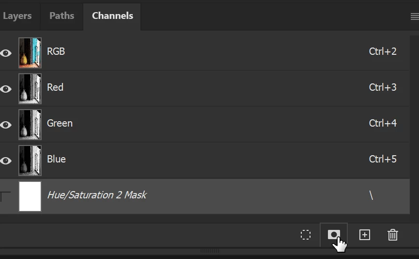

Most likely the file is fine.
If you save the selection to an alpha channel, Windows Explorer/desktop will interpret that as transparency and display it accordingly.
In a lot of applications, an alpha channel atomatically equals transparency, although that is not necessarily correct (according to the file format specifications of the formats that support alpha).

An Alpha Channel is a saved selection.
You can save selections in the Channels panel.
