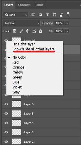

Hi bartonlew!
The Layers Panel is the correct place to do this. There are a couple options.
To simply turn on/off all the layers without shift clicking or scrolling - right click the visibility toggle (eye) of any layer and select "Show/Hide all other layers. This will turn on every layer, including layers grouped under folders.
If by chance you have layers grouped under folders that you do not want to turn on, but want all your top level layers/folders on – Close/minimize all folders with layers underneath that you do not want turned on, Select layer at the top of your layers list, then scroll to the bottom of the list. Hold "shift", and then select the bottom layer. This will highlight all layers. Then press Crtl and comma to toggle those selected layers on and off.
