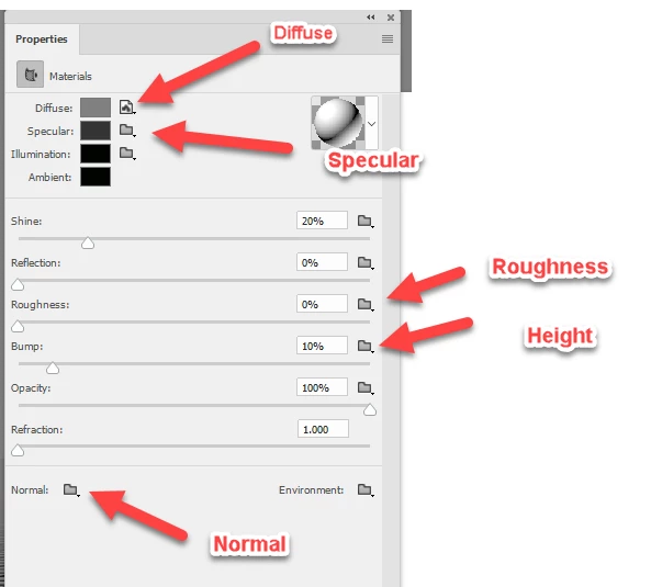

    The mdl materials can be used with Adobe Dimension.
    The materials are using a Metallic/Roughness texture set which is not supported in Photoshop 3D but you may be able to get close by plugging the maps in as shown - provided you can find the diffuse colour map
    You will need to adjust the reflection manually
    Dave
