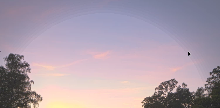

while i like the overall, neutral results compared to other hdr-tools, i run into artefacts/problems as soon as a sky is involved - even in simple light scenarios (i.e. blue sky without head light).
I enclose an example.

    Hi I had to guess the relative exposures on the three images in your test file and enter them manually. When I did so I only got the severe banding when I checked the "remove ghosting" checkbox which seemed to pick up large areas of sky luminosity from the darker image

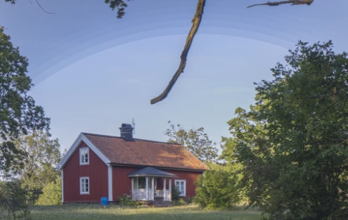

    Your example shows significant banding in the sky, which is something I've never seen in Lightroom or Photoshop.  Rather than try to determine the reason for your issues here I think it best that you have a read at this document prepared by Adobe to assist users get best results from the HDR feature. I suggest you take particular note of the number of images (less than you might think) required for optimal results.

    as i said, doing hdr for years and with other programs, so can estimate how things are about to look. i don't get banding with other programs at all in easy settings like the above. nearly in every one, with lightroom/hdr-pro

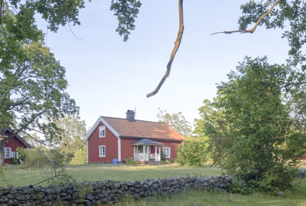

    another extract example is now attached. i assume, one gets the point, although dis example is in a difficult light situation.

    this is an example, how hdr efex pro handles the same images - without the hint of a problem

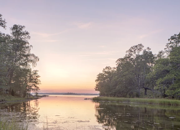

    and also an extract of the difficult image, no hint of a problem within hdr efex pro
