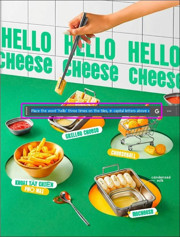

This is typically a job for Nano Banana.
(Place the word ‘hello’ three times on the tiles, in capital letters above each “cheese”, using the same green colour as for ‘cheese’.)
c.pfaffenbichler
Nov 28, 2025 10:09 AM UTC
With regard to maintaining editable text (within a Smart Object) a Layers-based approach would offer advantages over an AI-based one (at current) but if the task is a »one-off« it may not be worth the trouble anyway.

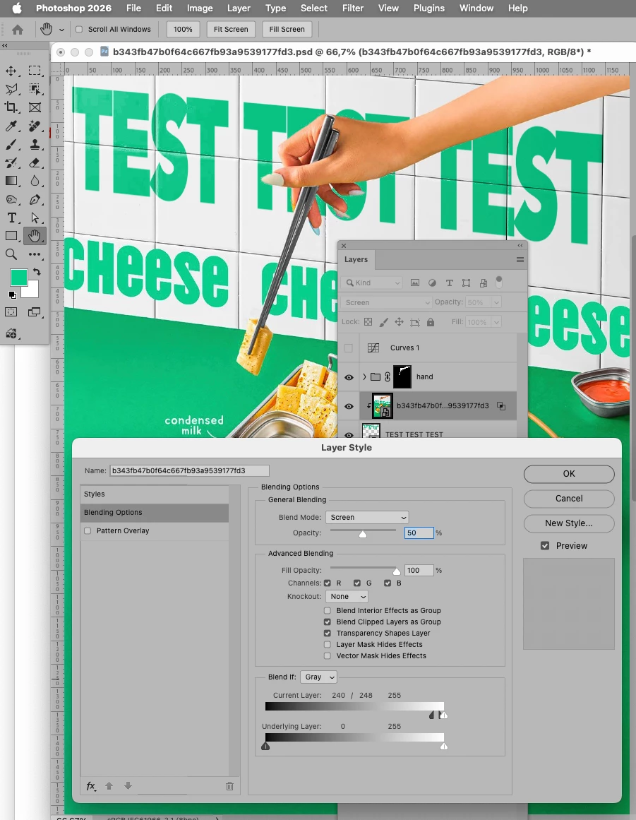

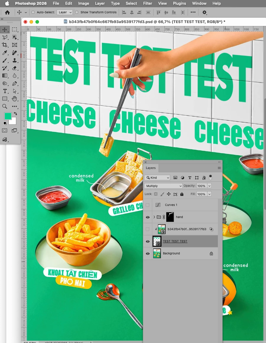

Nov 28, 2025 8:07 AM UTC
Setting the Type Layer to Blend Mode »Multipy« and using a Blend if-setting on a screening copy on the background image would be one option.

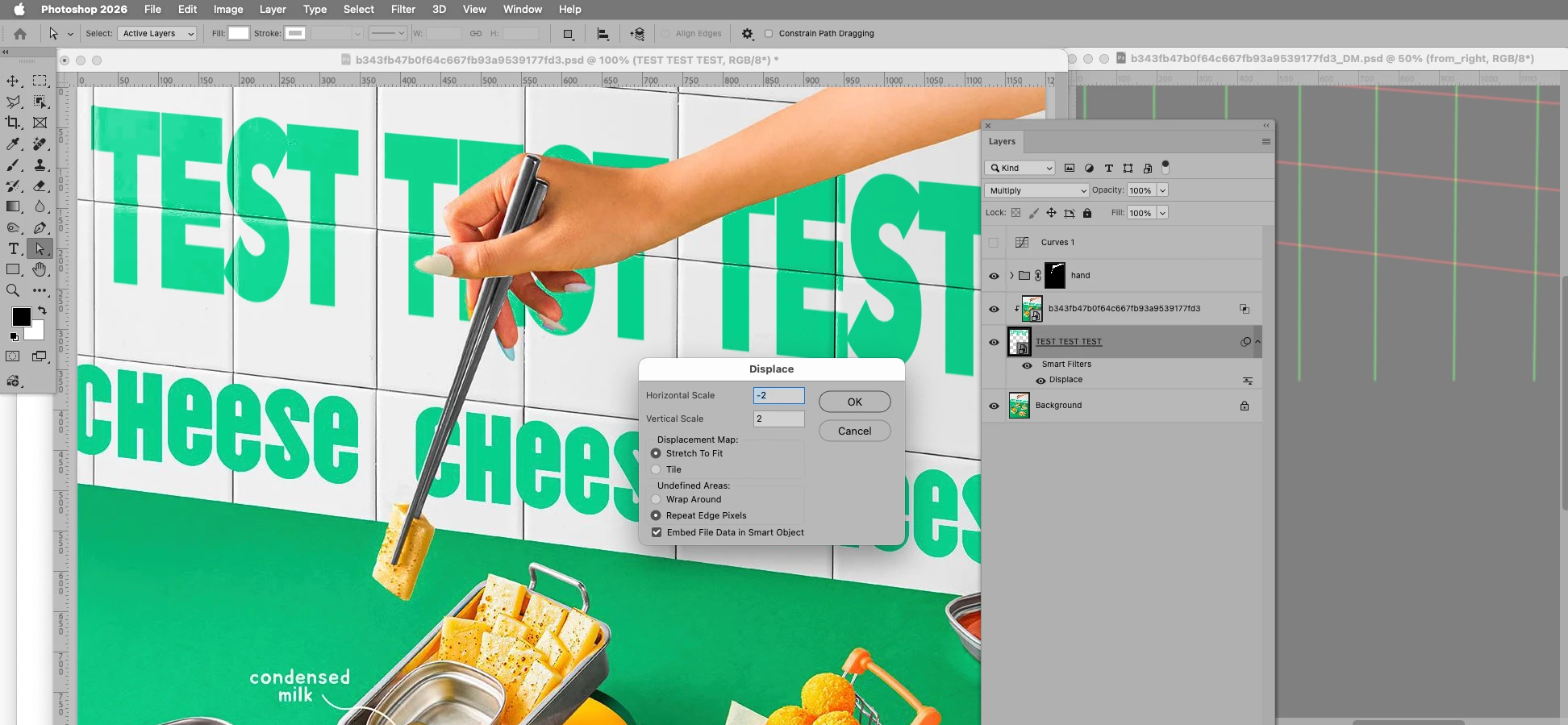

To distort the text along the seams one couold us the Filter »Displace« with a custom Displacement Map – the Filter Liquify would also be an option but seems cumbersome in a case like this. (The Filters should be used as Smart Filters.)
