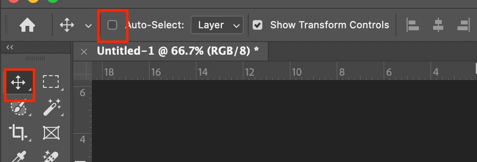

 Kevin,
There is no auto-select box in my PS, even after selecting workspace to essential and resetting essential.  The box that says layer has the selection show here.
Dan
What’s shown in your screen shot is how the options bar looks when the setting Enable Narrow Options Bar is on. To see the default options bar that Kevin showed, turn off Enable Narrow Options Bar in Preferences / Workspace as shown in the picture below. But the menu you popped up does look like the Auto-Select setting when Enable Narrow Options Bar is on, so if that works fine for you and you like the narrow options bar,  you don’t have to disable that.

@Tape99 While on the move tool, make sure you have the option to Auto Select checked on.

Kevin Stohlmeyer
Aug 7, 2025 4:00 PM UTC
Hi @Tape99 the move tool has to be selected to see these options.
If you dont see the options bar at the top go to Window>Workspace and Essentials or Reset Essentials.
