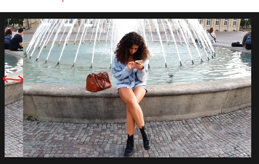

when I open a normal mp4 into photoshpop 2024 as well as the beta version it takes a small part of the right side of the video and moves it to the left. This happens to any mp4 that I open. How can I fix this?

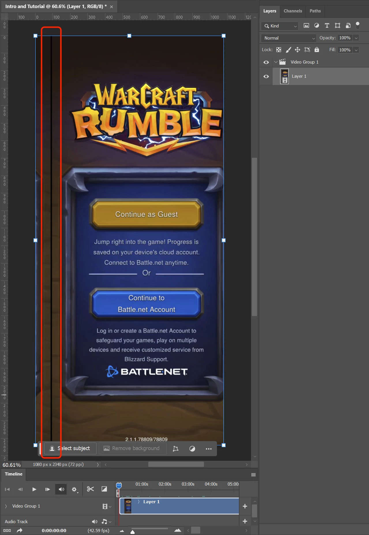

December 11, 2023
When I open a video file through Bridge or a Photoshop file with a Video in it, the video is offset.
If I close Bridge and Photoshop, then open Photoshop alone the problem is okay.
I don't want to have to do this everytime as I usually open Bridge and work from there.
I have the most recent version of Photoshop installed, but I did try older versions.
I am using a PC wirh Windows 11.
Help!

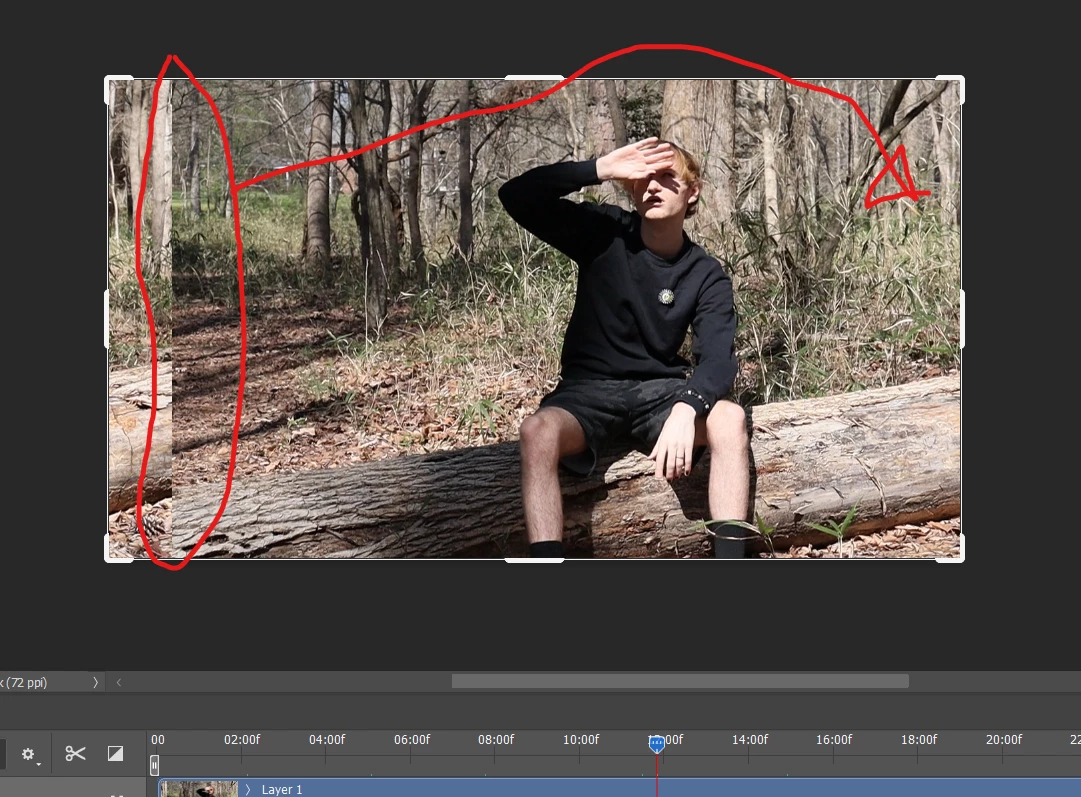

November 20, 2023
I've got a bug where my video files (both .mp4 and .mov), when opening in Photoshop with a weird offset happening in the composition. See the red section in the attached screenshot. I'm working on Windows 10 Pro.
Is this a reported bug, and there's a solution in place for it or not?
Thanks in advance for your help.
November 20, 2023
Also, I'm on Photoshop 25.1.0
