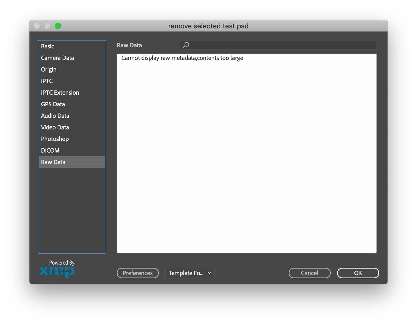

Stephen Marsh
October 28, 2020
If you go to File > File Info and then the Raw Data tab, do you see a message like this?
