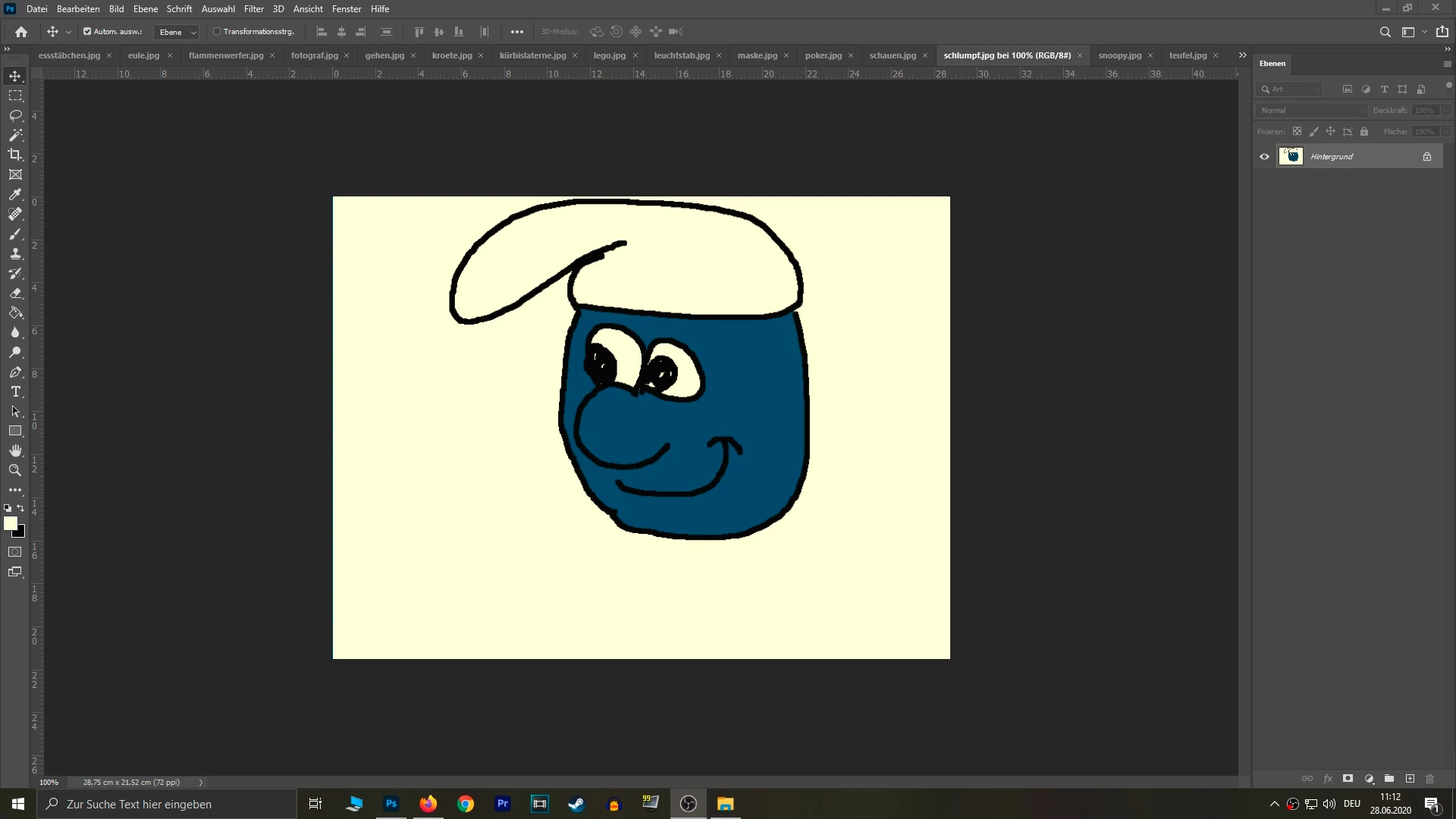

my photoshop is yellow-ish not white
My problem: My working surface is yellow-ish. All colours appear to be more yellow-ish than they should be as you can see in the pictures below.

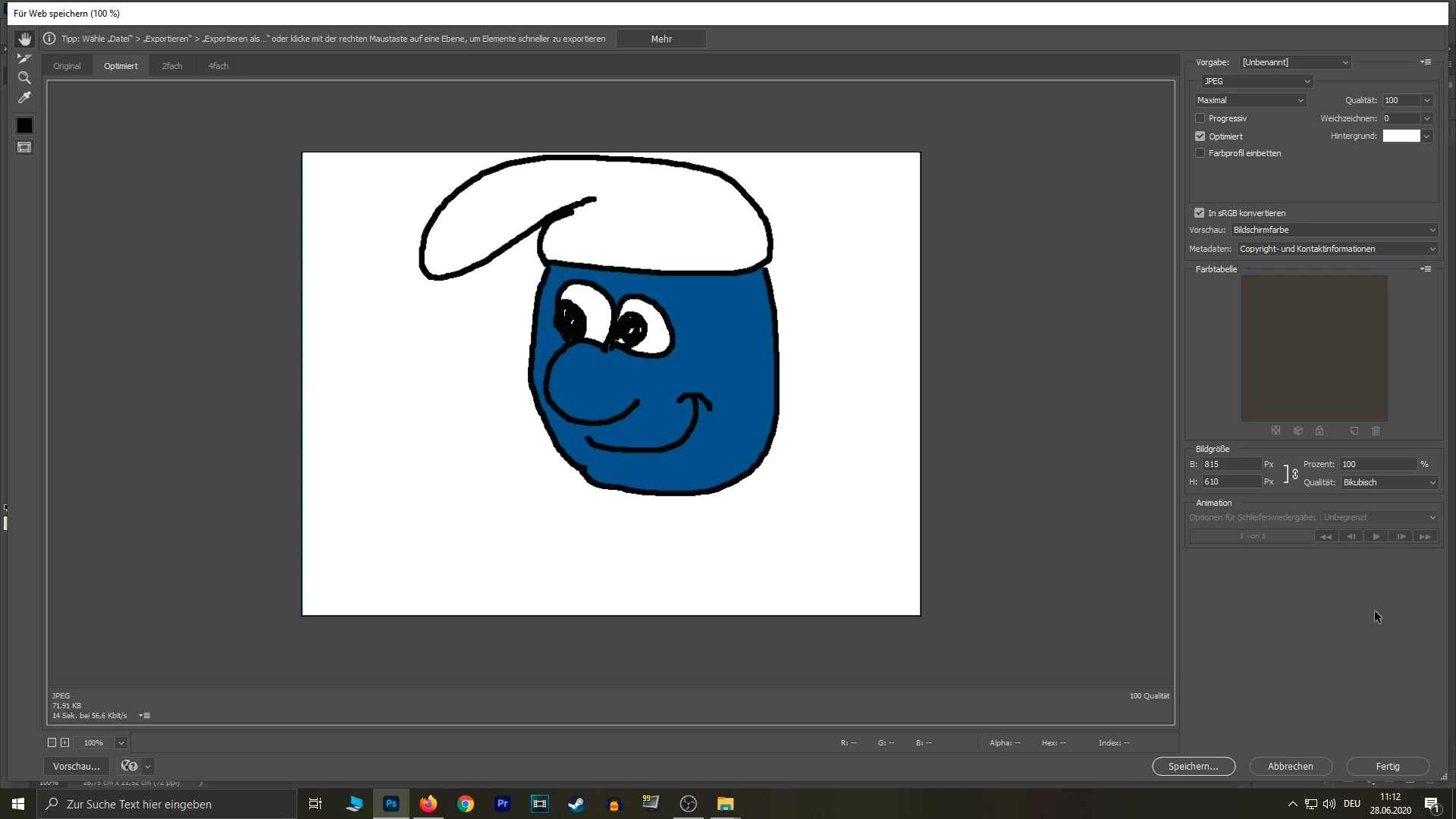

When i export the picture it is normal again (not yellow-ish anymore).

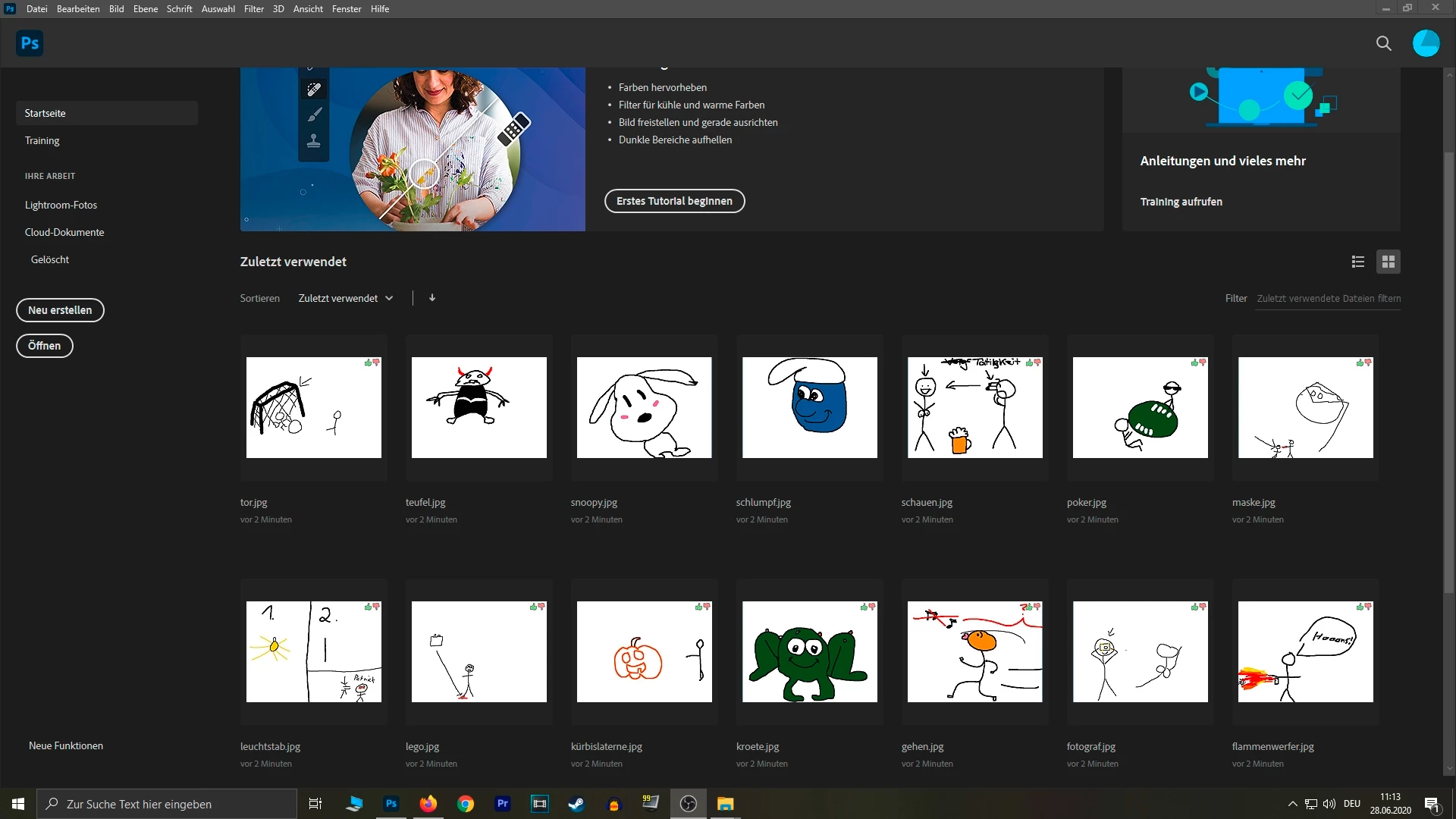

Also the pictures in the preview are in the original colours (not yellow-ish).
As you can see it's yellow-ish just in the working surface.

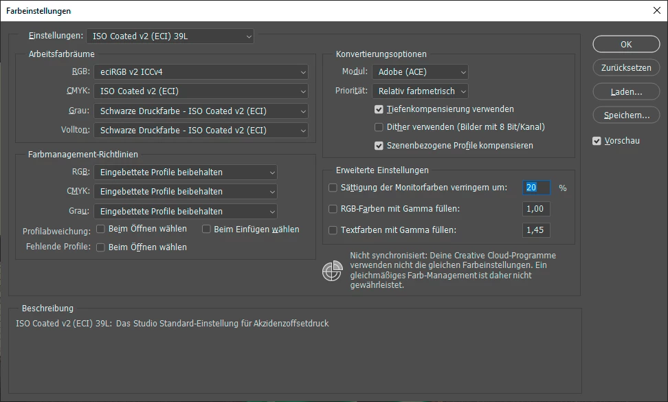

These are my colour settings ... well in german. Also i don't use the view of a proof.
Maybe some of you have a clue for me.
Thanks in anticipation!

Jul 11, 2020 8:55 PM UTC
That's a broken monitor profile. If you have a calibrator, rerun it. If not, get one.
In the meantime you can use sRGB as monitor profile as a temporary fix. It won't be accurate, but better than a broken profile.
Save For Web at default settings has all color management turned off, and the monitor profile is ignored. If you enable it by checking "embed profile" and set Preview to "use document profile", it will use the monitor profile to display, and match Photoshop.
In the same way, your photo viewer used to view the exported file is probably not color managed either.
Don't change anything in color settings! That's not where the problem is.
Jul 11, 2020 9:11 PM UTC
Seems to be right. Thanks a lot!
