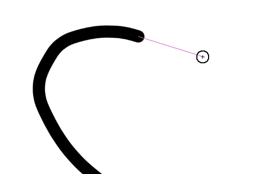

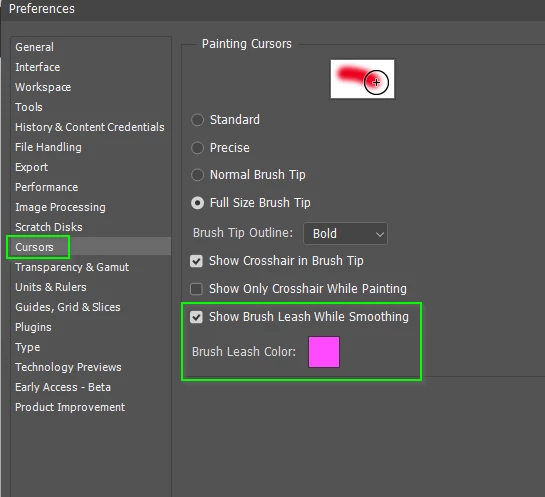

Try turning on the Brush Leash visability in Preferences > Cursors
That will give you a better idea of how it is working.  100% smoothing can actually make things worse because the long leash means the brush stroke will be too far behind the cursor to smoothly move through a small radius change of direction.  I'm thinking this effect would be magnified with larger brushes and low spacing because of lag.

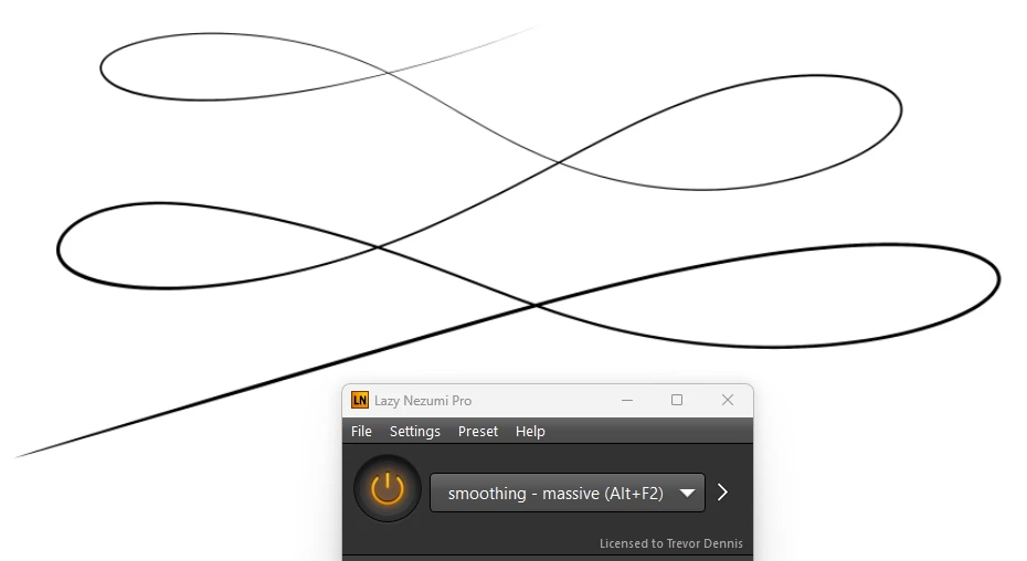

If you were still using Windows, you could use Lazy Nezumi Pro, which has much better brush smoothing than Photoshop's native feature.

Thank you for your answer, but it is still not fixed, I made another video with that setting turned on. It is just not smoothing my brush as it should. How can I fix this? Because I need the lazy mouse feature.
https://www.youtube.com/watch?v=UJN8cADmEHs

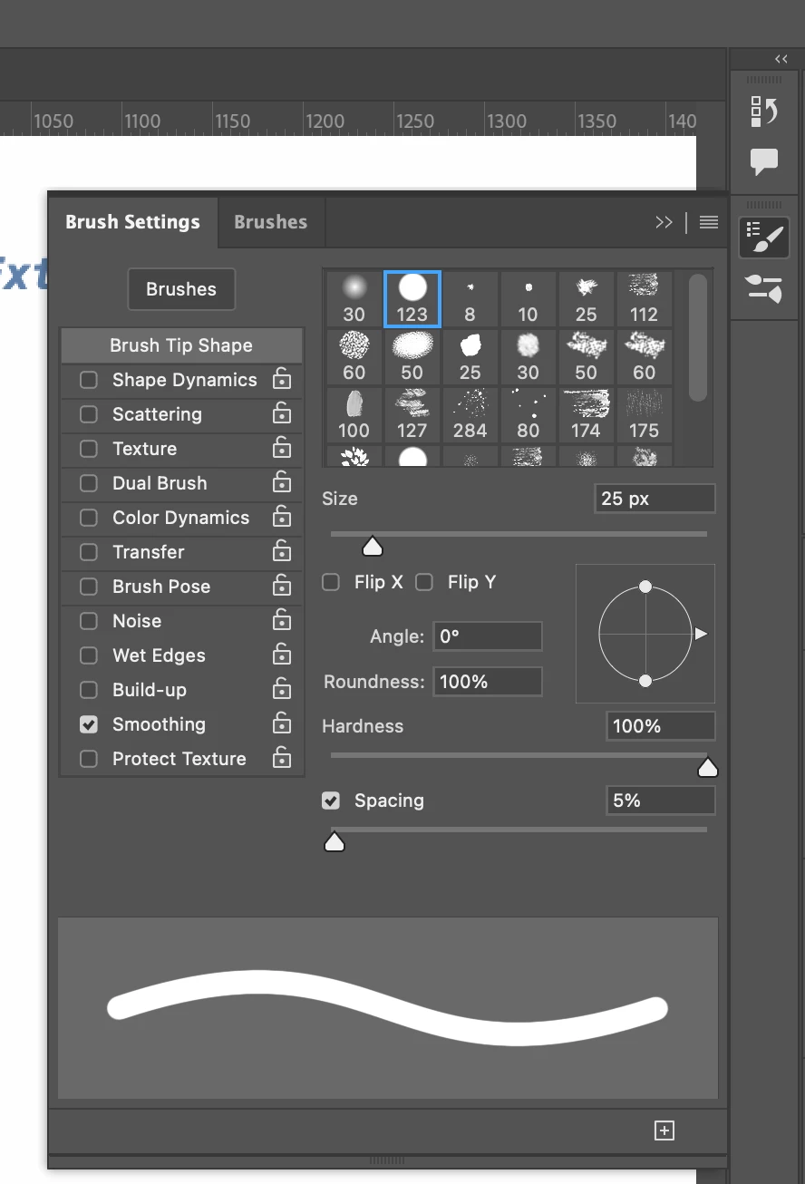

davescm
Feb 5, 2025 9:08 PM UTC
What are your settings under smoothing options (click on the cogwheel in the options bar next to the smoothing value to check)?

To be honest I rarely use smoothing at that high level due to the slow strokes but I tried the same settings here and it looks normal, fast smoothing unless you hold the mouse at the end where there is a slow down toward the catch up. If you lift the pen, or mouse button during that catch up it stops drawing and goes to the next brush stroke.
I checked this in two versions, Photoshop v26.3 and Photoshop 24.7.5 both worked the same way.
