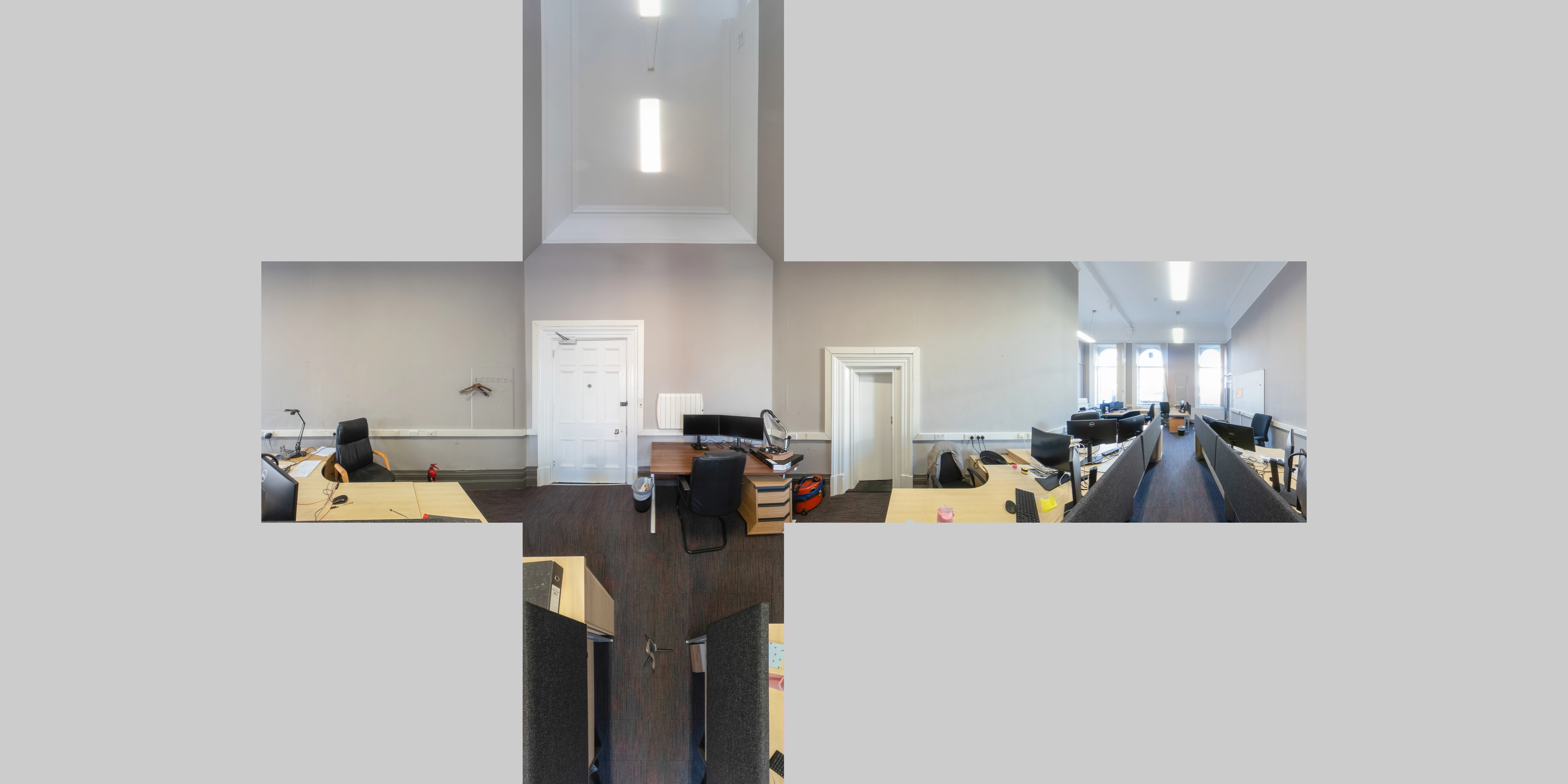

I have a series of 100+ images I created for a client (see example) which are 360º images, transformed into a horizontal cross shape (using Flaming Pear software). Client is an architect and will be creating a book of reference images of a building that requires renovation. The shape was chosen so that text and other photos could be added in the white space around the main image. This allows them to highlight problem areas etc. The problem is that the "white" background areas are not uniformly white (instead they range from white to grey). which messes up the look of the book (they are using Word). They are now asking if the images can be supplied with no background (make it transparent?) so they can put into a Word document and then add other elements around the image. I hope this makes sense. I understand I should be using Actions in conjunction with Batching, but my knowledge is very limited. I have made a note of the exact pixels from which the background area radiates i.e. the corners of the central square of the image. I want to remove the background from those points on every image.
How do I accurately make a selection of the grey background using the pixel information I have? NB: I tried various auto-selections and it selected parts of the image, so would like to make manual selections. Do I then save this as a mask to be used on the other images?
What steps do I need to achieve this in an efficient way when recording my Action? e.g. apply selection/mask, cut background, flatten, rename, save in original folder.

Hard to comment as the image upload is incomplete. One possible "out of the box" option:
https://community.adobe.com/t5/photoshop-ecosystem-discussions/jpeg-with-outline-path-to-transparent-png-files-conversion/m-p/13055741#U13071607
https://www.marspremedia.com/download-confirmed?asset=batch-web-images.zip
https://www.marspremedia.com/software/photoshop/batch-web-images
https://m.youtube.com/watch?v=Fes9ApyIMhM
Otherwise, record an action using Select Subject and adding a mask or otherwise clearing the background of a floating layer, then run via Batch, Image Processor etc.

The image you posted does not seem to have passed the virus-scan so far.
Clipping elements from photographic images is (or at least can be) a serious task and full automation may not be reasonably expectable.
The use of Word for page-layout seems inappropriate to me.
But you probably have little influence on this, so you may have to provide pngs for images with transparency.
