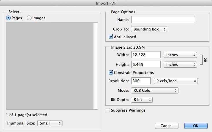

In the Photoshop script I'm writing, I ask the user to open a file using:
     open(File(openDialog()));
That works fine. But the user will always be opening an Illustrator (.ai) file.
Normally that brings up a dialog box called "Import PDF".
But that dialog doesn't come up with this open command and just uses the default options. I need to set 2 values: 1) uncheck Anti-aliased, and 2) Mode to CMYK.
I'm new to this and I can't figure out how to set those options. (I don't understand Adobe's Javascript documentation.) Can someone help?

Thanks again for your help. I finally got it figured out. I knew there had to be a simple solution:
    var OpenAIFile = new PDFOpenOptions; // This sets the parameters for opening the .ai file
        OpenAIFile.antiAlias = false;
        OpenAIFile.mode = OpenDocumentMode.CMYK;
        OpenAIFile.resolution = 300;
    var SelectedFilePath = File.openDialog("Select the file"); // Prompts user to select the .ai file
    var CurrentFile = open(SelectedFilePath, OpenAIFile); // Opens the .ai file and sets parameters

As I look more, I think I need to set the parameters this way
But what Open command do I use, and how do I insert these parameters?
