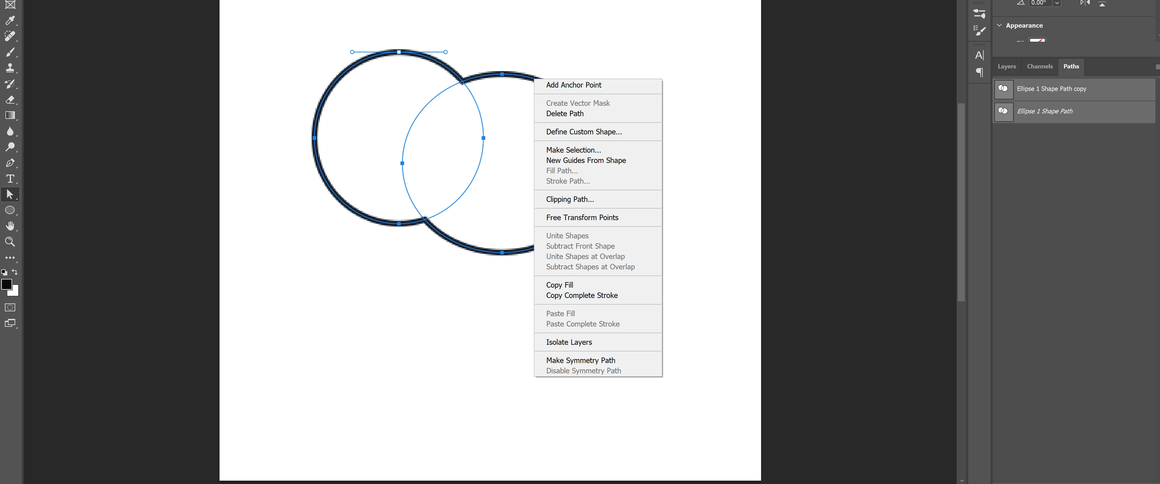

My next question is, I would like to be able to make shapes by combining or excluding shapes together. I can no longer use the stroke with brush idea when I do this.

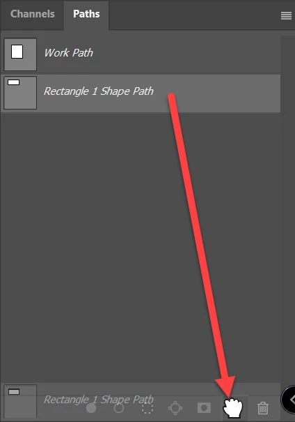

2. One way to create path from shape layer is to select shape layer in the Layers panel then drag its path on the new path icon at the bottom of Paths panel to duplicate it as a new path which can be stroked with the brush.

2. I dragged the path as you show in your image to the new path. This created a path called Ellipse 1 Shape Path Copy.
3. However, when I select this path and right click the option to stroke or fill are greyed out.
