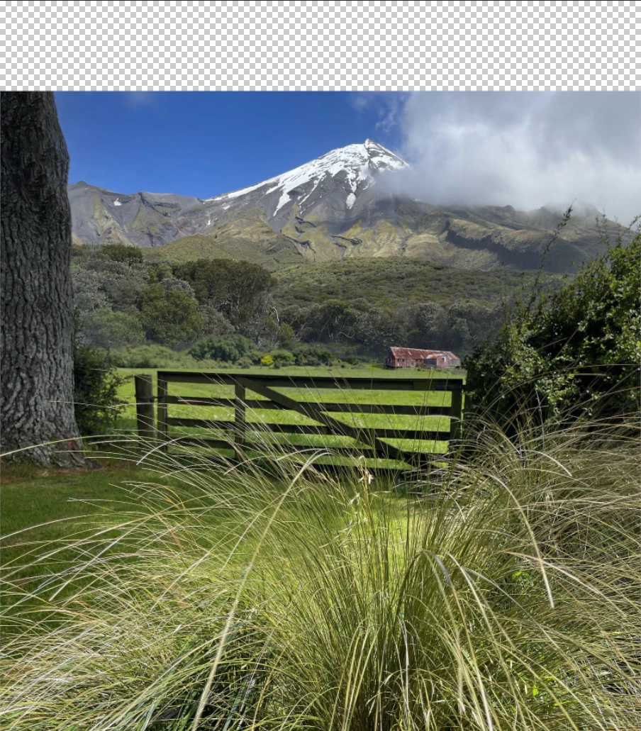

As an example, the image below has some smoke from the volcano out on the sky area, but I want to change the sky and replace it with a night image, leaving just the smoke as it is.

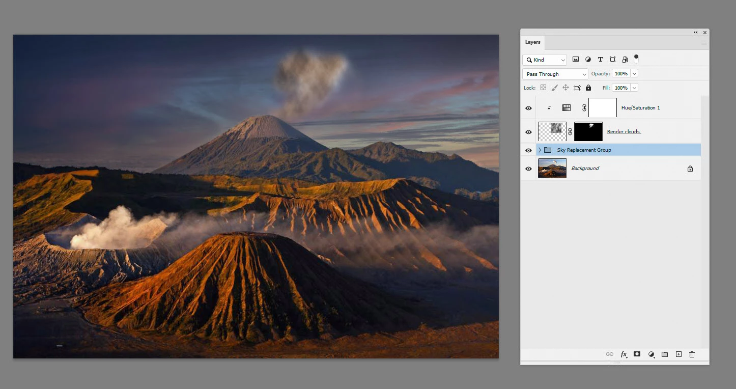

Render clouds is an old filter and is not AI driven
I used it here, after replacing your sky and masking out the existing smoke which sky replacement left in.
First I used render clouds then transformed it to get the cloud variations small (it was greyscale as my foreground and background colours were black and white).
Then I added a black mask and brushed in the cloud shape
Finally I clipped a hue and saturation layer to it, setting it to colorise and adjusting the cloud colour

Hi Sara.  I'm afraid this is going to be one of those 'it depends' situations. What is the colour of the volcano smoke, and what would you like the sky to look like?
Does it have to be the original smoke? i.e. could you use Generative Fill to create some more?

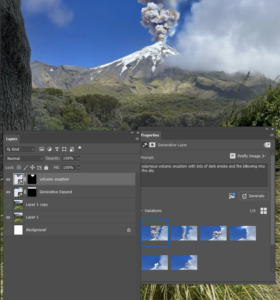

This is mount Taranaki on a rare day that you could see it from below.
I used Generative Expand with the crop tool to give it some room for the smoke to fill, and then used Generative Fill to create an eruption
If you share your image, we'll be better placed to give you advice on using masks, blend modes, or whatever to achieve your desired effect.
