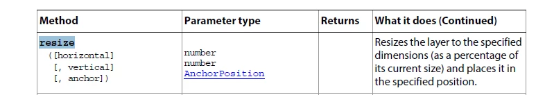

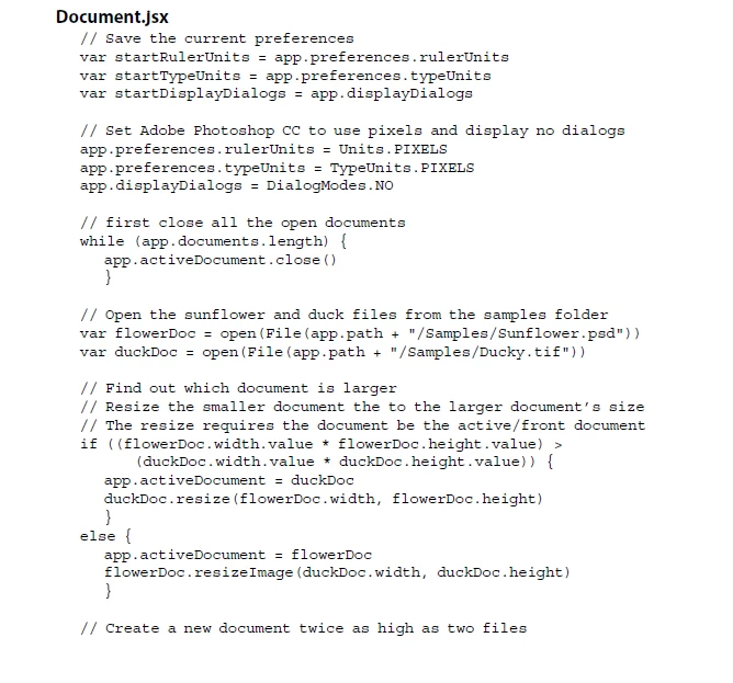

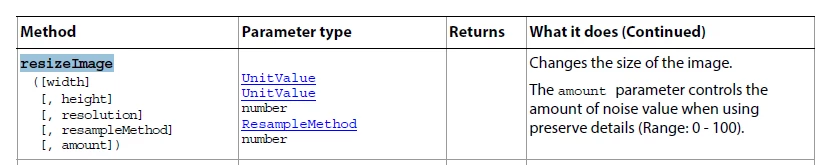

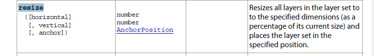

The latest Adobe documentation is downloadable from this link Adobe Photoshop Scripting  the link you post it shows in photoshop-cc-javascript-ref-2019.pdf page 95
and on page 96 the example code
Only width and height is required.... The ducDoc was opened from a tif file the may be an error in the code the statement  in there I believe should be
duckDoc.resizeImage(flowerDoc.width, flowerDoc.height);
not
duckDoc.resize(flowerDoc.width, flowerDoc.height);
for Resize seems to be for a layer and layers within a layer set and is a relative resize and other thinhs like selections
The resize in the example code may also distort the image for I see no logic to preserve the documents aspect ratio. The resized document would not be distorted if  both image have the same aspect ratio.
