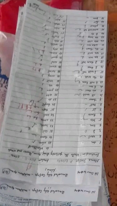

Hi All,
I have taken a pic of my text document using my cell phone however due to inadequate lighting condition
the image got blurred and not fruitfully readable. Can any one let me know how and what can I do with Photoshop
to improve the photo quality for reading purpose.
More over since I could not use flat surface to put the page hence image text is also distorted at some extent.
Can anything be done for this also? I am completely new to Photoshop hence please explain me in a very simple
way.
way.
thanks,
Ravi

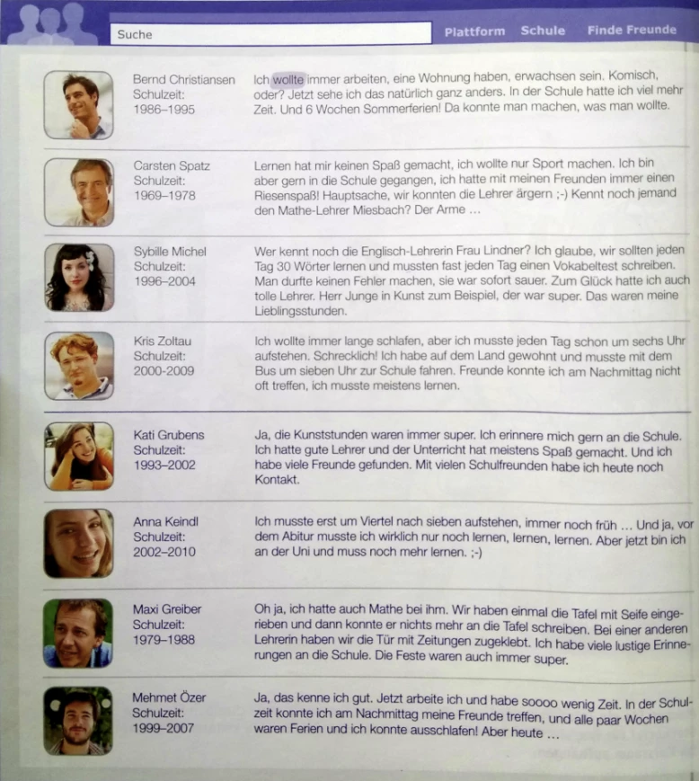

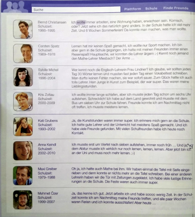

yes. attached is the modified image after following your suggestions.
not working as expected.
need more advice on this.

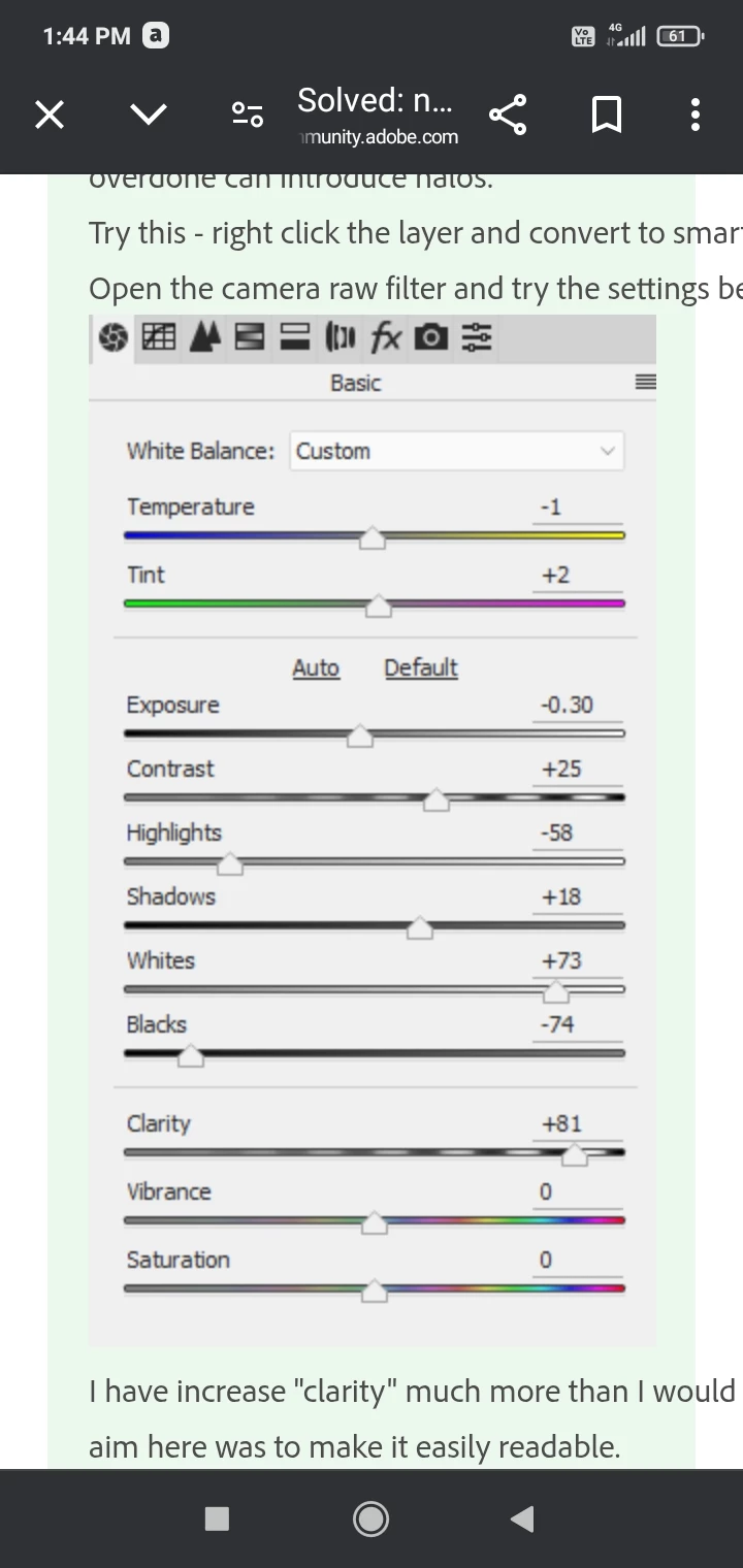

Hi

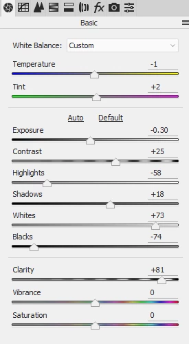

The trouble with "sharpening" is it is often done by increasing the contrast of edges which when overdone can introduce halos.
Try this - right click the layer and convert to smart object.
Open the camera raw filter and try the settings below :
I have increase "clarity" much more than I would for a normal photograph, but you said your aim here was to make it easily readable.

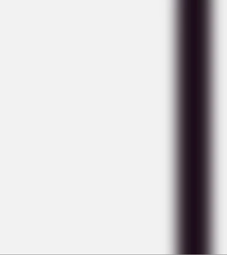

100% sample
Click to view result at 100% (the forum software will blur it at less)
Dave

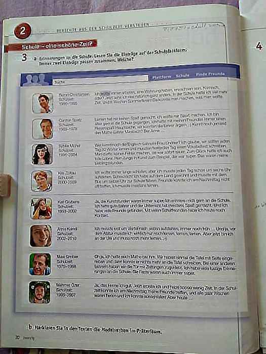

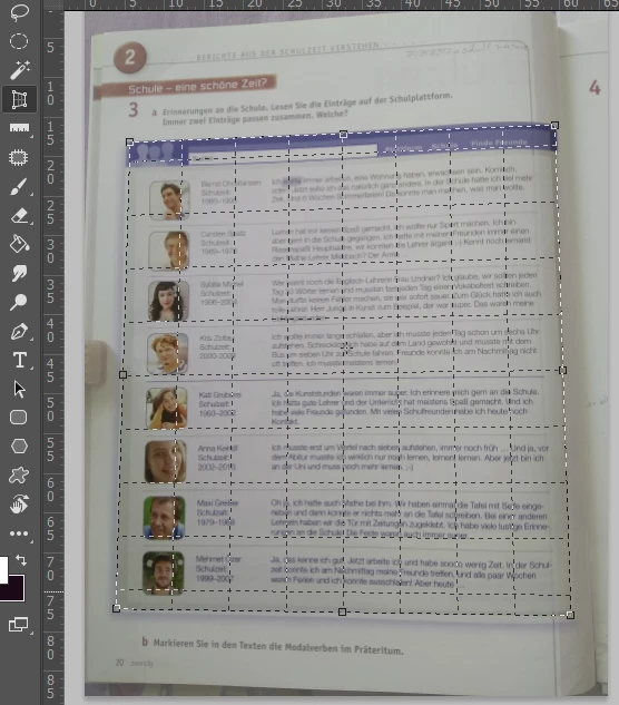

Perspective Crop is a great tool for straightening out this sort of 'taken at an angle' image
That leaves a distortion due the curve of the page near the spine though
If that was the full height of the page, you could fix it with a Displacement Map with a map like this
You'd need very low settings, like 2,2, which gives you this.  Not perfect, but more time making the map would do a better job.
The distortion is not the full height of the page, so correcting a copy and using the map on the top half of the copied layer gets you close.
Sorting out the background with Curves or Levels and sharpening finishes the job.  Note this was quick and dirty for the demonstration, but taking 30 minutes instead of two, would make a world of difference.
