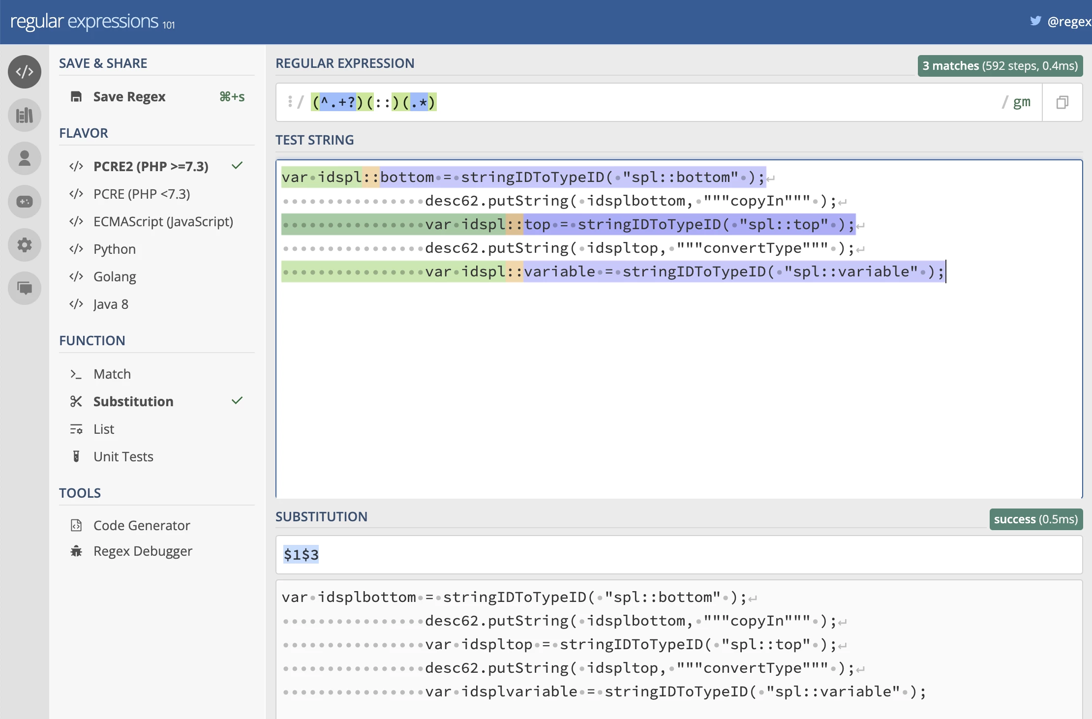

Correct answer Stephen Marsh
I'm reading the OP differently than some others. Remove the first :: in each line, retaining all other :: thereafter. Any regex enabled program or a website such as regex101 or regexr can fix the code for you. Here is a sample screenshot of the regex with colour highlighting:

I'm totally new in scripting and need help.
I have some scripting-code (only a snippet) from Script-Listener, but it has a few bugs. As you can see, every variable has a name with 2 colons (::). How to delete these colons without deleting the colons of the stringIDToTypeID?
Can this be fixed in the script-Listener or can this be with a regex in a script? How?
                var idspl::bottom = stringIDToTypeID( "spl::bottom" );

Any help is welcome.
Regards
Oliver

If none of the :: are correct a global replace of :: with : should do.

Nothing should be a problem with that line. I would use double qoutes instead of the single quotes. Neural filters has issues with recording and playback, getting better each release. But it should do something. Make sure you upgrade to our 23.0.1 that came out yesterday.
I missed the :: for the varialbe name. See regexp solution below. I told them that :: in their key names was a bad idea. I'll see if I can fix ScriptListener for this case.
