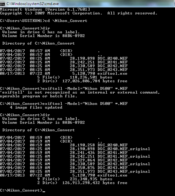

I used this workaround to edit the EXIF properties for my D7200 as well it worked for my new D7500 as well.  It makes the D7500 NEF look like a D500 (same sensor) NEF in Lightroom.  Hopefully you are not afraid to run programs from the Windows command (CMD) program.
1. Download the freeware exiftool.com into a directory where you are going to perform the NEF conversions.  I created a root directory C:\Nikon_Convert
2. Transfer the D7500 NEFs of interest to the C:\Nikon_Convert directory
3. With cursor over the Windows Start (lower left icon), left mouse click and then type CMD into the "Search Programs and Files" bar
4. From the command line, change directory by "cd \Nikon_Convert"
5. From the command line, enter "exiftool -Model="Nikon D500" *.NEF"   and this will convert all files with .NEF extension to the D500.
6. The tool will rename the original and create a copy with the updated EXIF model number (see above).
7. Import into Lightroom and edit/adjust/view your D7500 pics.
July 4, 2017
Looks great!
It is working fine on my computer. Is there any disadvantage of this solution? Any loss of quality or something? I suppose this is a temporary solution until Adobe will relase next version of Camera Raw and/or DNG Converter.
July 8, 2017
You are only changing the EXIF Label so no impact on the image.  The only disadvantage would be once Adobe updates Lightroom, you can import directly.  Glad it worked for you!
