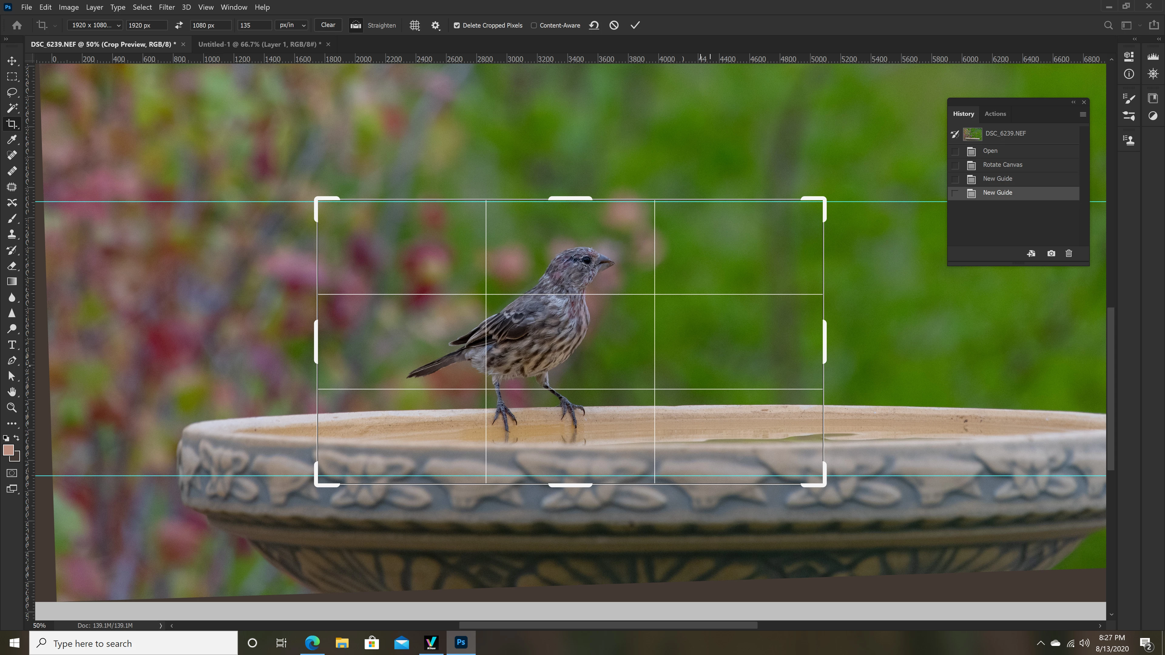

I feel like I have searched for a short cut for this topic for years and I'm thinking someone here can help me out.  Is there a process in Photoshop that will ensure I don't crop below 100% image resolution?  For example, I take a photo of a bird and want to crop as close as I can to the bird without losing image detail/resolution. Currently I right click on the image while the zoom tool is selected and than choose 100%.  I get a good look at the image then go to the crop tool and select the area I remember seeing.  Ocassionaly I'll use guides to indicate how close I can crop as in the attached sample. I'm probably making too much out of this but it would be nice to be able to limit the crop without eyeballing or guessing.

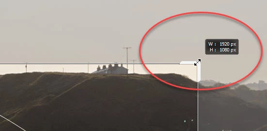

If I understand you correctly, you want to crop your image to your screen size  1920 x1080 pixels with no rescaling, so just the excess pixels are trimmed away.
If so - set the crop tool to Ratio 16:9 not Height x Width x Resolution
Then move the crop handles watching the on screen size until it says 1920 x 1080.
You can then move the image around  by dragging inside the crop area, to get the best position, before accepting it

From what I can see on your screenshot you are cropping to some specific dimensions and specific resolution or in other words you have values in W, H and Resolution fields in the Options bar. Do you want to ask how to crop actual pixels without any interpolation?

Looking at your screenshot, I'm guessing that you have a 45 MP camera, and that the pixel dimensions of the image are around 8256 x 5504, which is the resolution of the image.
If you crop the image to 3000 x 2000, you'll get a 6 MP image. The image quality will not be reduced, but it won't contain enough pixels to make a large print.
If you print the original image at 300 ppi, the print size will be 27.52 x 18.34 inches. (divide pixel dimensions by ppi to get print size in inches)
If you print the cropped image (3000 x 2000) at 300 ppi,, the print size will be 10 x 8 inches.
The bird would be the same size and have the same image quality in both prints.
