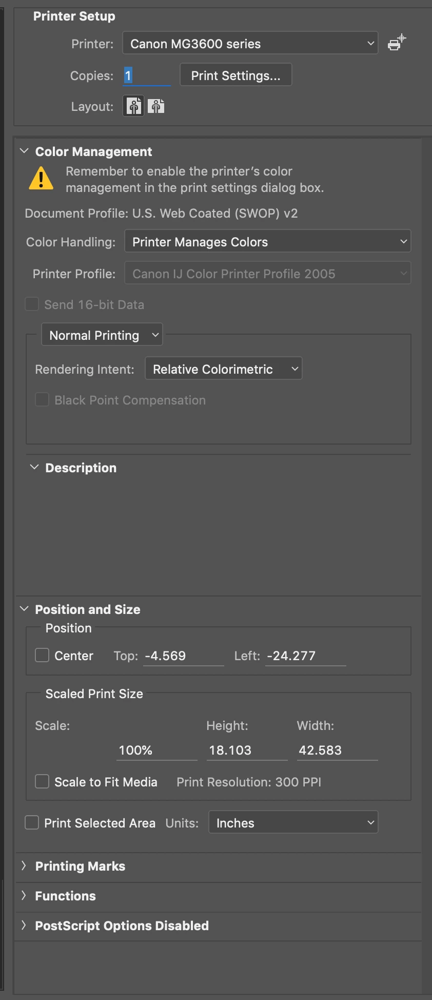

    As long as you have "Printer manages color" in the print dialog, it's all done in the printer driver. So if both PS and Ai are sending out US Web Coated (SWOP) numbers, and the profile is embedded, there's no reason they should be different.
    However, print settings are stored as metadata in the file. You need to have the correct settings in the printer driver (paper type and so on). Go over all your printer driver settings from both applications. They must be correct and identical.
    You'd get more predictable results with the application managing color, and thus handling the conversion from CMYK into RGB. But then you need to have the printer profiles installed. All inkjet desktop printers are RGB devices that expect RGB data.

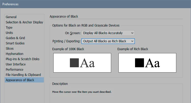

    This Illustrator preference is an option to display 100K black in the same way as rich/4-color black. Printing on the black plate only produces a charcoal gray, compared to the deeper black you get when printing all four inks.

    You're probably seeing the normal default behavior in the two apps.
    Illustrator by default remaps CMYK rich black to RGB 0-0-0, when it outputs to RGB devices like an inkjet printer. You set this in Ai preferences > Appearance of black:
    Rich black is inherently a little lighter than RGB black, since you can't have 100-100-100-100. That doesn't necessarily reproduce the actual reflectance of ink on paper, just this reduction from 400% ink to actual ink limit.
    Anyway, Photoshop doesn't have this option. It's permanently set to "output all blacks accurately".

    What are the settings you use to print, in particular as they pertain to Color Management?
