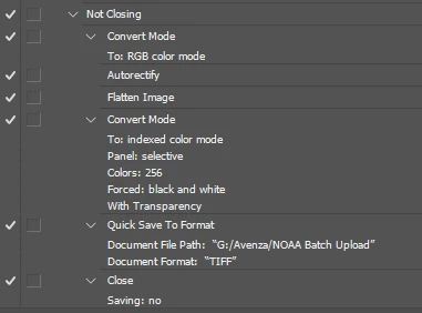

Here is the Action I'm running, some of the tools are from a third party plugin, but that shouldn't affect the Close action. Just tested again after clearing the preferences and had the same result. It finishes on one file and just leaves that file open when it opens the next one. After a few hundred files the temp data for photoshop gets bloated.

I see the Close no save step. It is there so it is either not working or not being executed.  It was recorded in the action after the Step
Quick Save To Format
Document File Path" "xxx"
Document Format: Tiff"

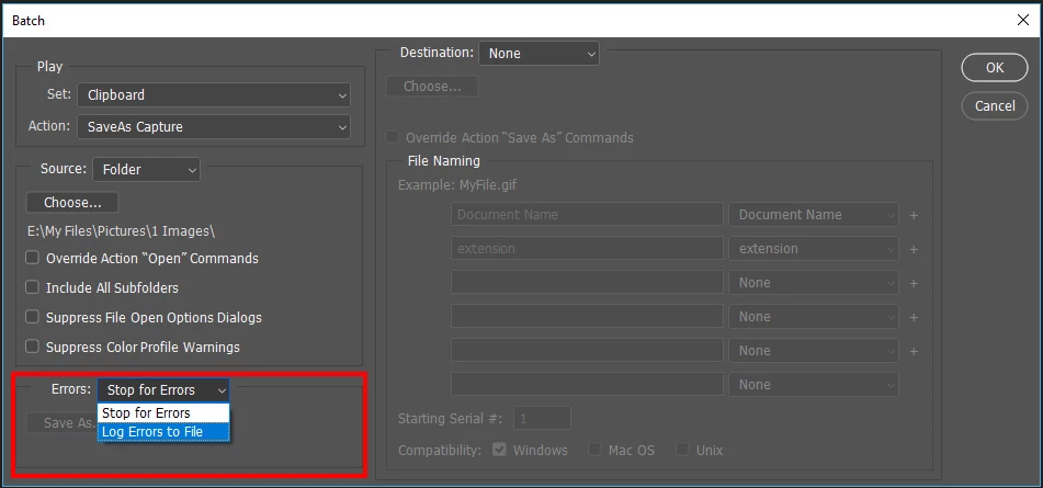

which was recorded before the Close No Save step.  I do not recognize that as being a standard Photoshop Command or Plug-in.  If it is a third party Photoshop Plug-in it has Action support programmed in for its names and setting used in its Dialog have been recorded into the action step.  If this step executes and you documents are being saved with their Document Name and are .tif or .tiff in folders "G:\Avenza\NOAA Batch Upload\" that step is execuring.  It also may may be possibly the Plug-in is  throwing an error or some how ending the action being platyed which would leave the current Document Opened by Bach open in Photoshop and Photoshop  Batch Process would move on to the next  file to be propcessed.  When you set up the Batch process did you leave it set stop on error or  have it Log errors.  If loged were any errors logged?
