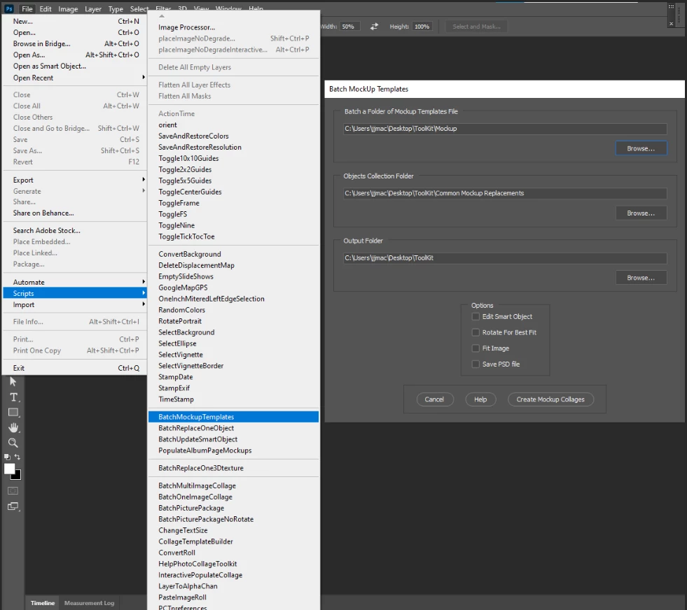

Oct 18, 2020 7:07 PM UTC
The "BatchMockupTemplates.jsx"  in my Free Photoshop Photo Collage and Mockup Toolkit  will do that but save the combines images as a jpeg and optionally as a Layered PSD. There is no option to save layered Tiff files.  All you need do is create a mockup template for how you want to combine the two images, and have the images in two folder and point the script to the templates, images collection and output destination.

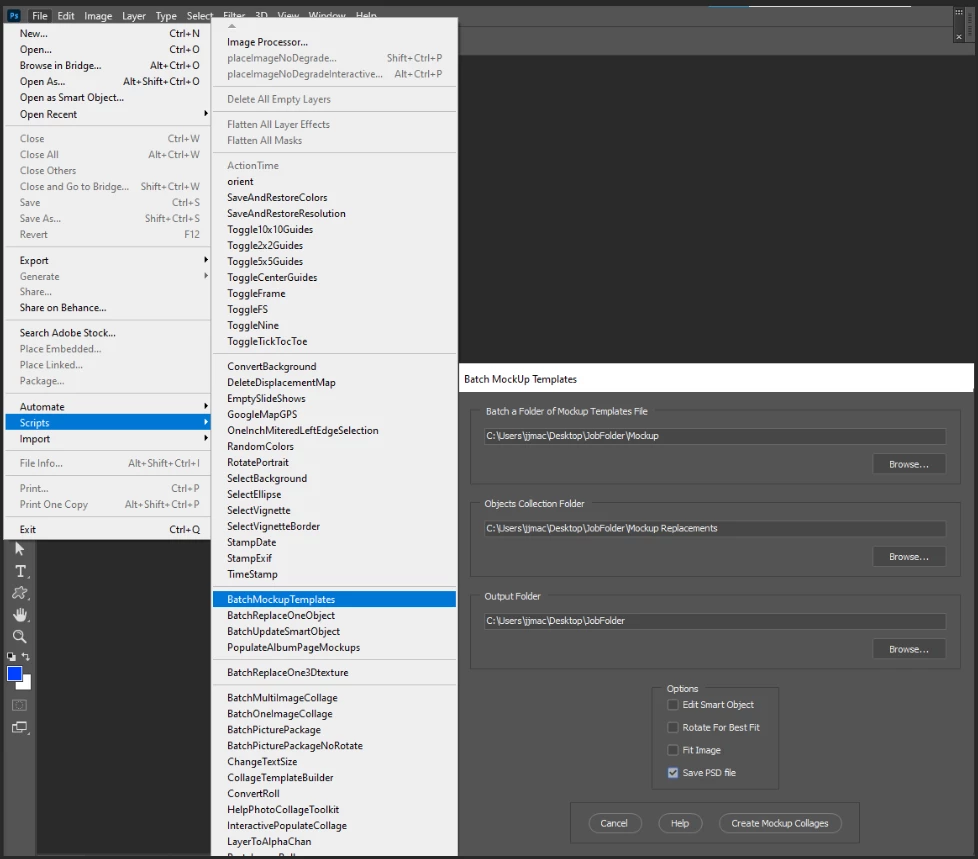

JJMack
Oct 20, 2020 4:31 AM UTC
To create the mockup template all you need to do is open a net document that has a canvas size and print resolution as your two image files.  Place in one Tif image to cover the canvas. then place in one jpeg to covet the first image. Set the layers opacity to 50%.  and save the document as your Mockup PSD template.
Put the mock in a job folder sub folder Mockup.  Create a Replacement Image collection folder in the job folder and in the collection folder in a sub folder obj0 and sub folder obj1. Store you jpeg files in folder objo and store your tiff files in obj1. The run the script do not forget to check save psd file
You could add additional mockup templates into the mockup folder where you would mask half the top Smart object layer to let the bottom object show in the mask off half.  An additional one where the canvas is twice as wide and you place the images in side by side the script would populate all three templates in a single run
