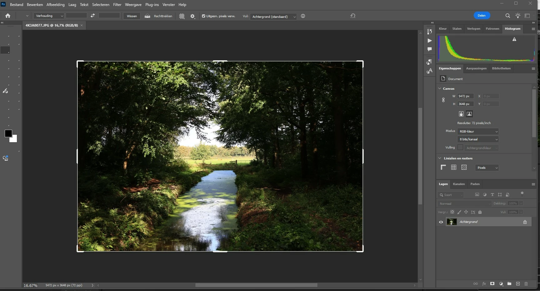

Opening a jpeg for the second time in Photoshop gives a weird toolbaar with dots
Asking for a friend (> English is a problem > Dutch).
Windows 11, with Bridge and Photoshop installed and fully up to date.
After opening a jpeg for the second time in Photoshop (via Bridge or not via Bridge) he has a weird toolbar on the left with dots (the tools are there but not showing) and the masking tool selected.
Opening a RAW file via Bridge to Camera RAW and then open it in Photoshop gives no problem with the toolbar.
What we did to solve it:
*Ctrl+Alt+Shift as we launched Photoshop to reset your preferences to their defaults.  (did the same with Bridge, just in case).
* Created a new workspace with the toolbar intact (but it does not show up after opening jpeg for the second time in Photoshop.
* Reset the settings of the toolbar to its default (in the preferences.)
We Googled but did not find a solution.
Any Ideas what could be the problem or how to solve this. I suspect a bug...
