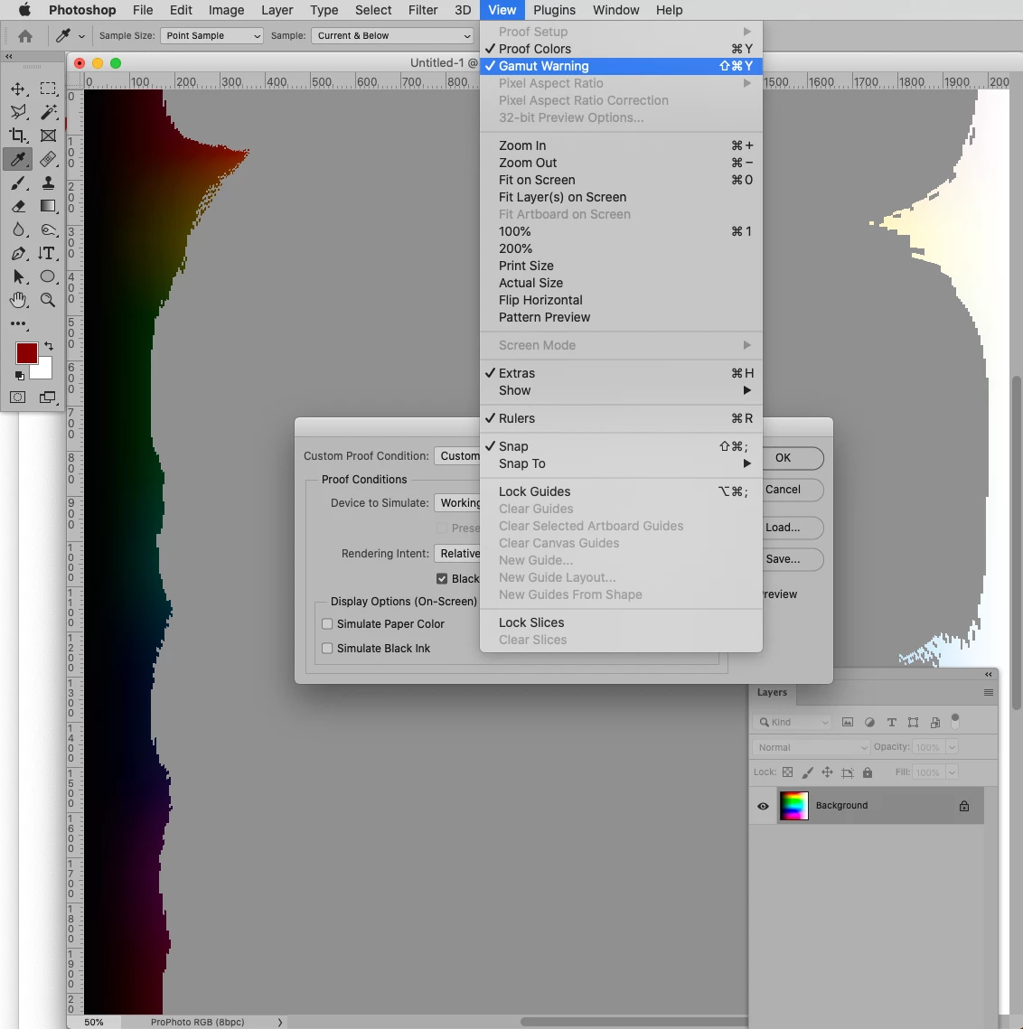

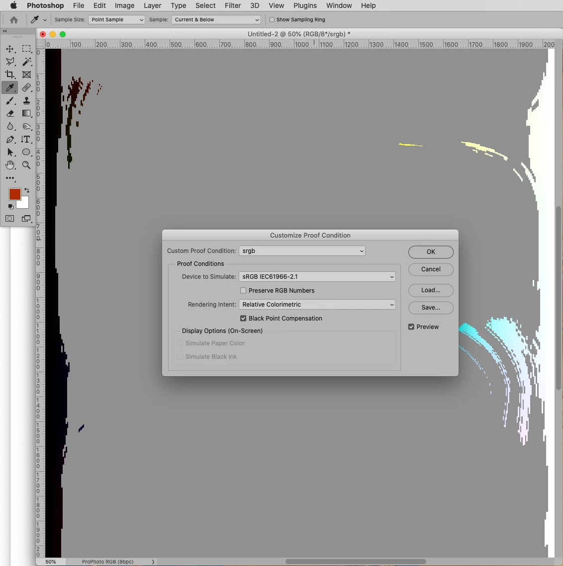

c.pfaffenbichler
July 18, 2021
I can’t reprouce the issue.
Please post meaningful screenshots to illustrate.
Edit: Sorry, the last screenshot did not show the Proof Space.
