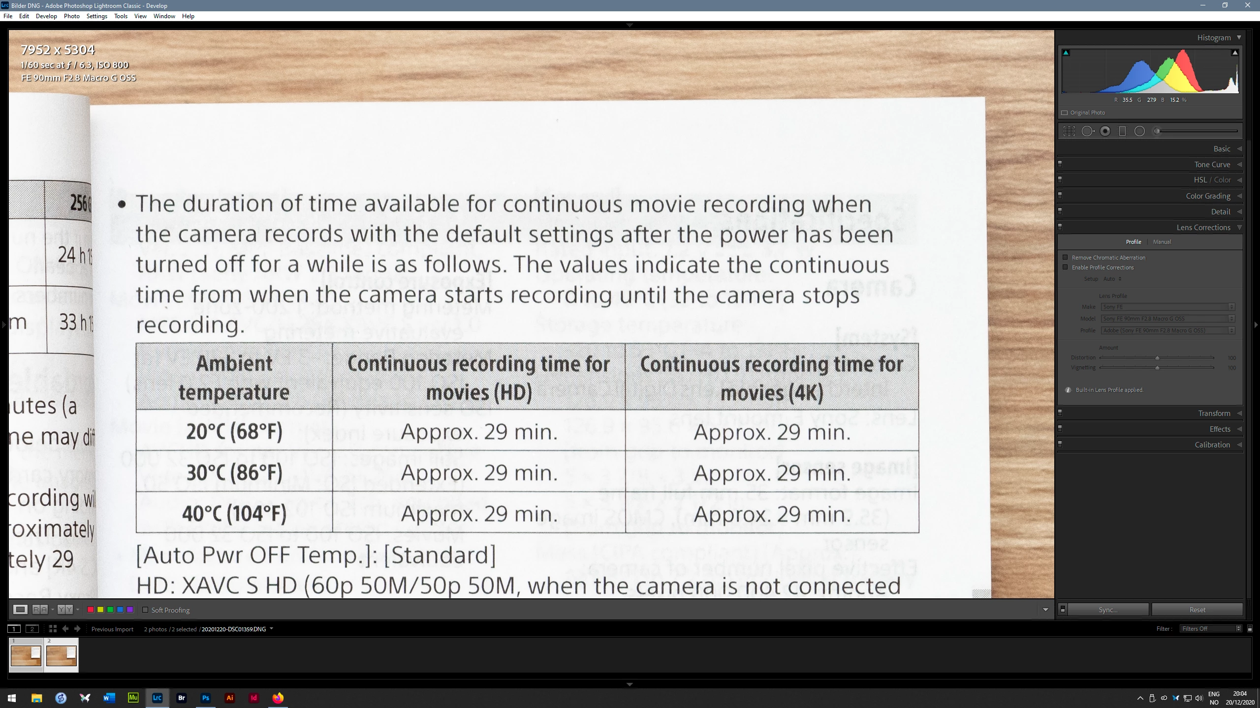

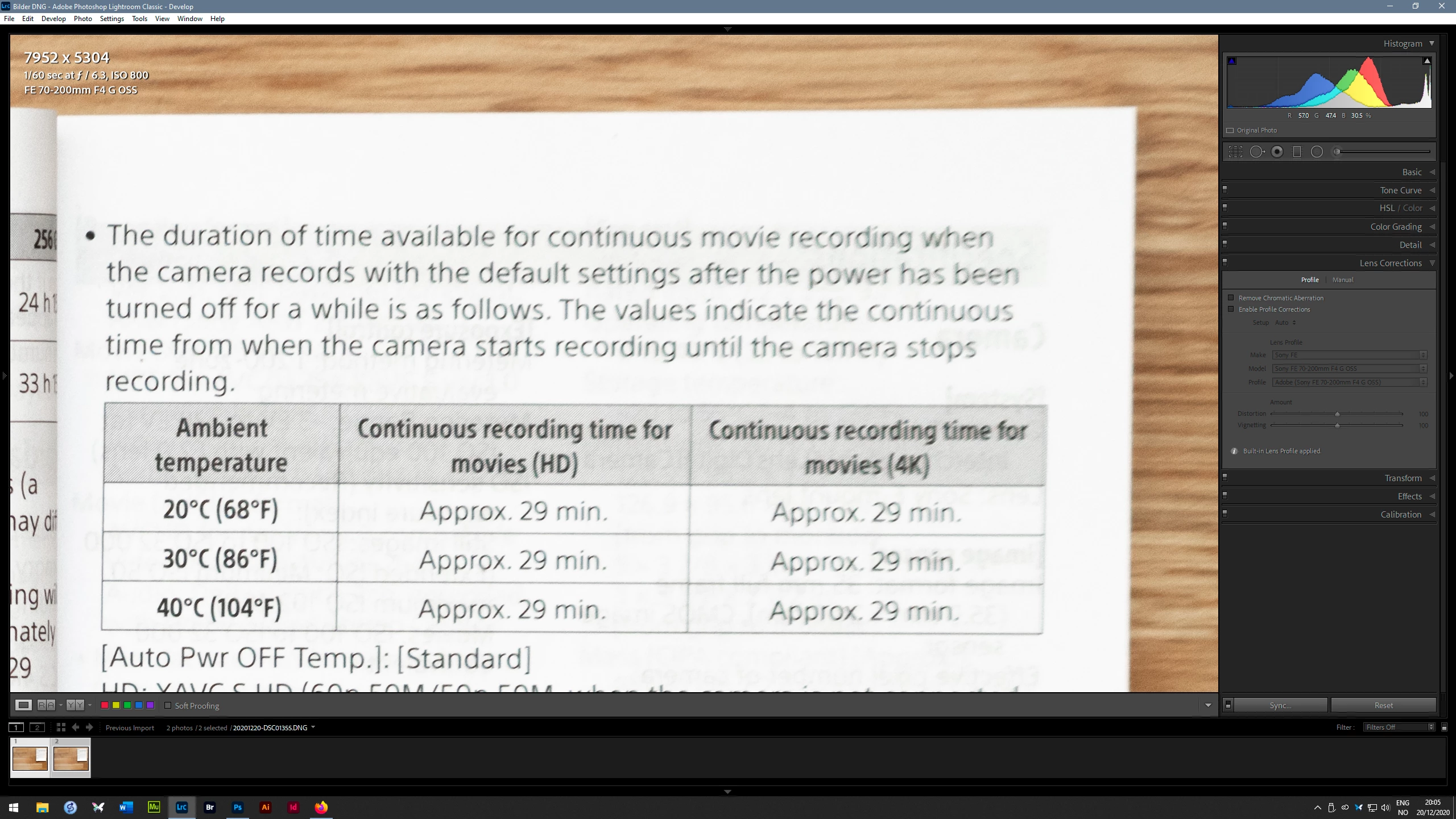

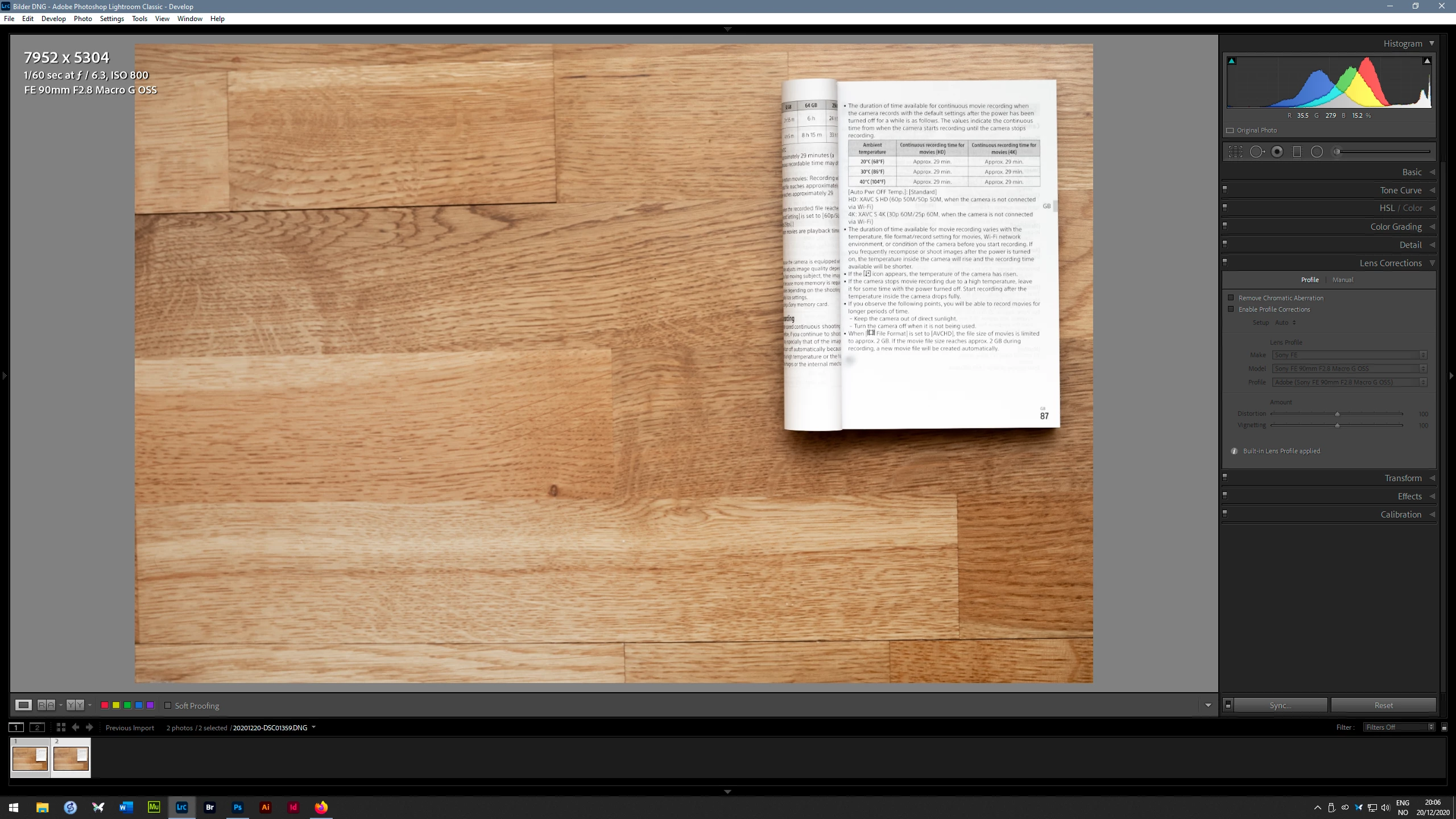

I took this test image with the Sony 90mm/2.8 macro, vs the Sony 70-200/4 @ 90mm. I turned off all lens corrections to get an impression of just the optics.
The 70-200 is in itself a fine lens, not cheap at all - but it is a zoom, with all the compromises that necessitates. Even though it's very sharp at the center, it's no match for the 90 in the corners:
Full image:
Here's the 90:
And here the 70-200:
Full image:
Here's the 90:

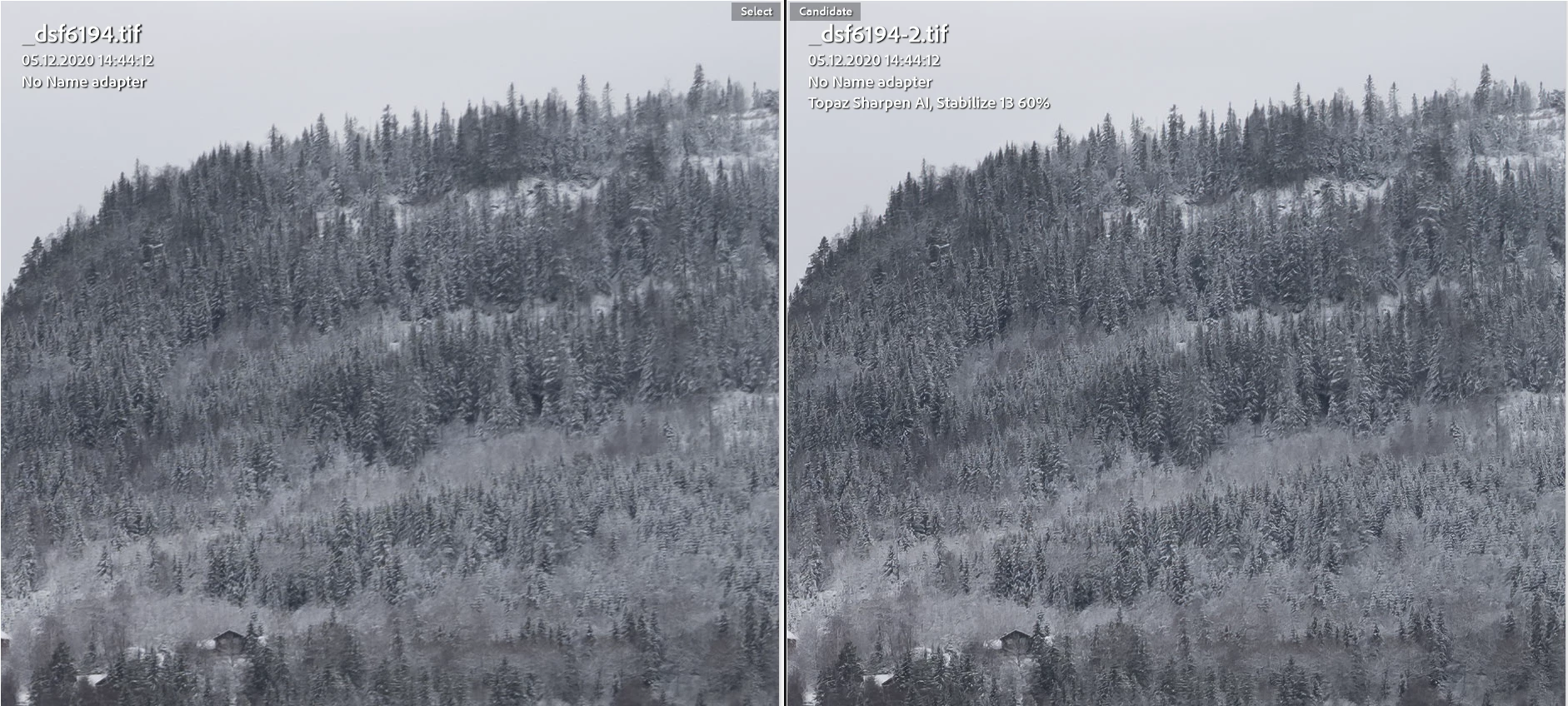

The Stabilize function in Topaz Sharpen AI does a great job of sharpening up blurred edges.
It has a semi-proportional effect – it applies more sharpening in blurred areas than in sharp areas.
Even so, I often find that the sharp areas then get too sharp, this can be fixed by painting on the layer mask. I always do this kind of sharpening on its own layer. This also allows you to fine tune sharpening by changing the layer's opacity. I found 60% to be suitable in this case.
The image below is the top right corner of a 50 megapixel image.
It was shot using focus stacking, I took seven shots on a tripod, each focused at a different distance. This workflow enables you to use the best aperture of the lens (f/8 in this case), and get maximum performance from the lens.
It's possible to process focus stacks in Photoshop, but dedicated software, like Helicon Focus, will produce better results.
For the lens I used here, focus stacking wasn't enough, left and right edges were still blurry, especially at infinity.
This is probably caused by field curvature, which is very common with wide angle lenses.
Make sure to view the screenshot below at 100% view.
