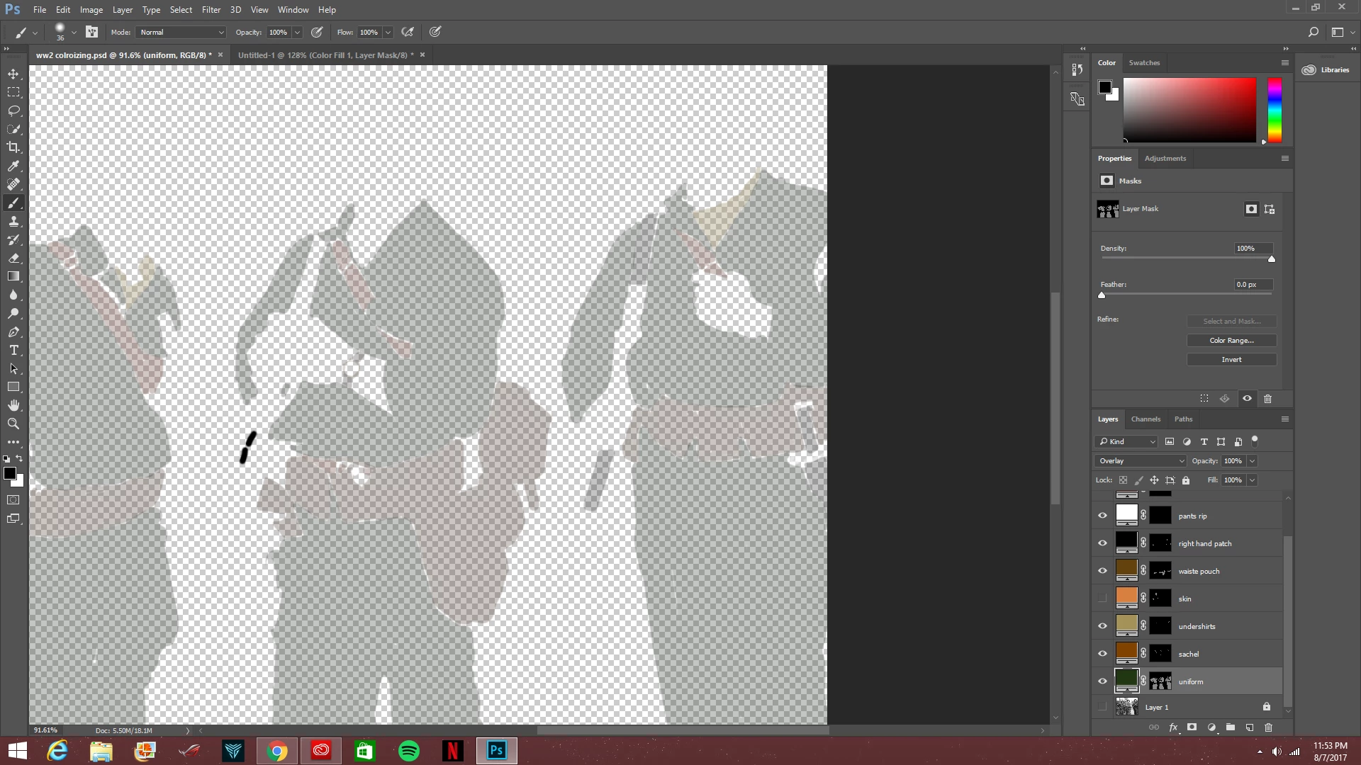

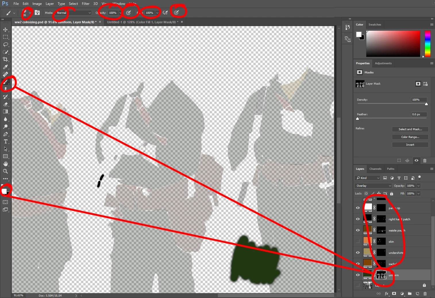

I have been coloring a black and white photo from WW2, i have been using solid color layer masks and the overlay blending mode.
     I do not know how things went bad. Now you can see the layers of paint over the original coloring. Overlay does not seem to be working.

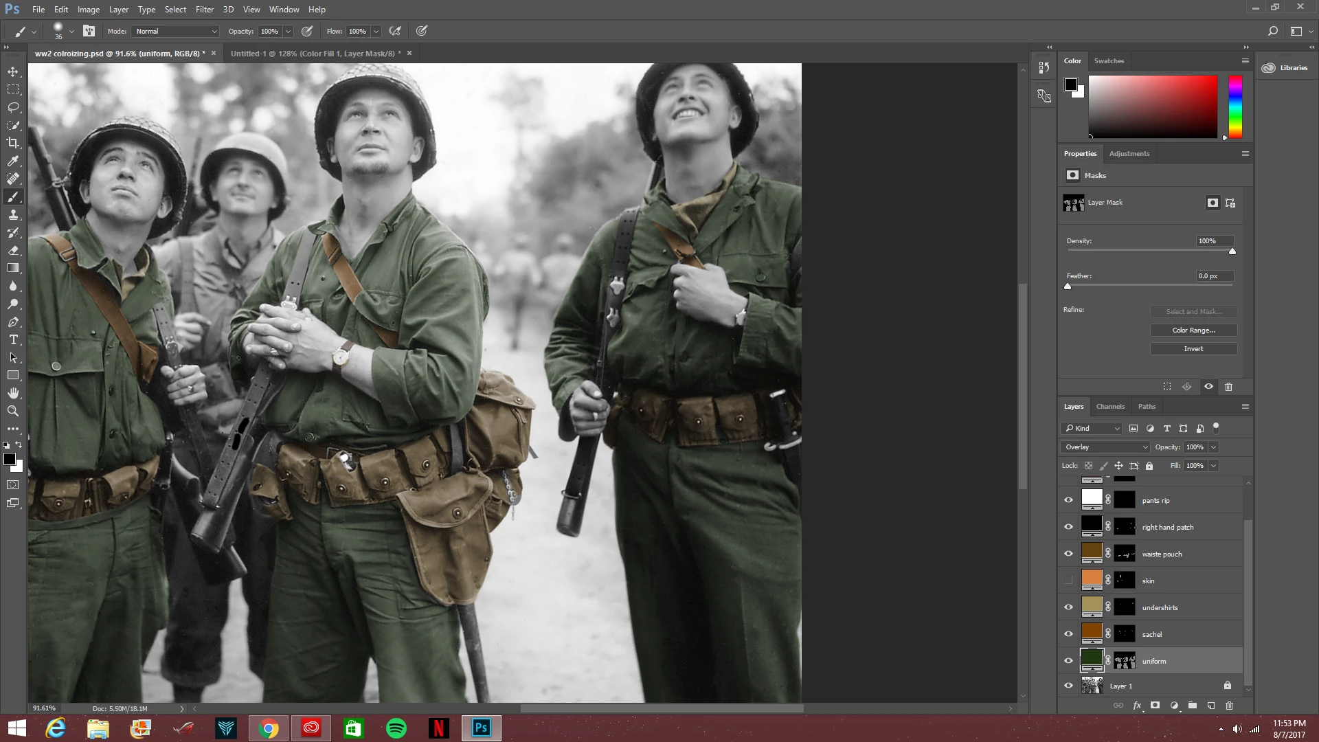

This is what it should be looking like with overlay(besides the 2 black lines in the lower left.
This is what it looks like with the bottom pic turned off.

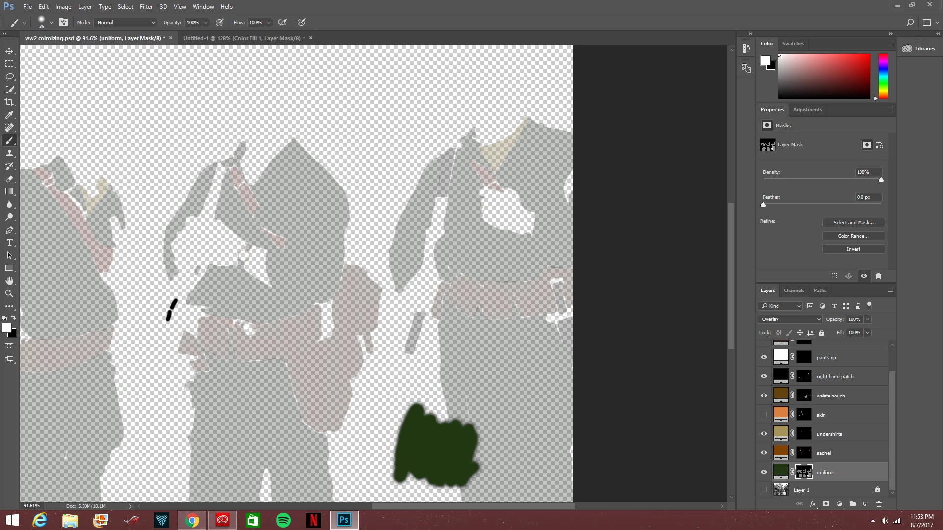

This is what it looks like now even with overlay on. I can paint over everything.
Any help is appreciated.

    It look like it is working correctly to me.  You are painting with white 100% opacity & fill normal blending on the solid fill olive green layer's layer mask revealing the solid color. The layer above that layer are masked off for the most part so the green of the overlay solid fill layer shows in the composite where you paint white. The overlay blending mode does not change the layers 100% opacity and fill.  Only the black and gray area of the layer mask does that. White will show the green area. There is no selection to constrain where you can paint. you can paint anywhere

    If your previous masked layers are showing as semi-transparent when the layer below is removed then  either the layer opacity has been turned down or the brush opacity was turned down whilst painting. Painting with a low opacity brush on a mask results in the mask being painted with grey not white - allowing the image to be semi-transparent.
