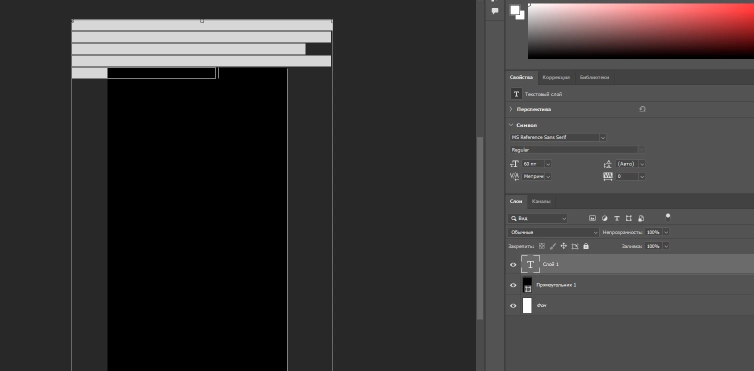

Hello, there is a problem with Adobe Photoshop 2022. When you enter text in a text layer, the symbols are not visible immediately, but after performing any actions with the text layer, for example, moving or exiting editing the text layer, the symbols are visible.
Dec 2, 2021 1:53 PM UTC

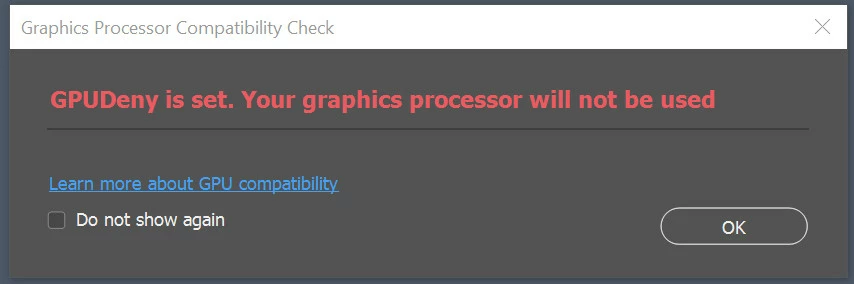

I had this same problem and the PSUserConfig file addition fixed the problem.  Upon restarting Photoshop a message appeared that needs to be accepted.
PECourtejoie
Nov 29, 2021 11:47 AM UTC
Hi, this is expected.

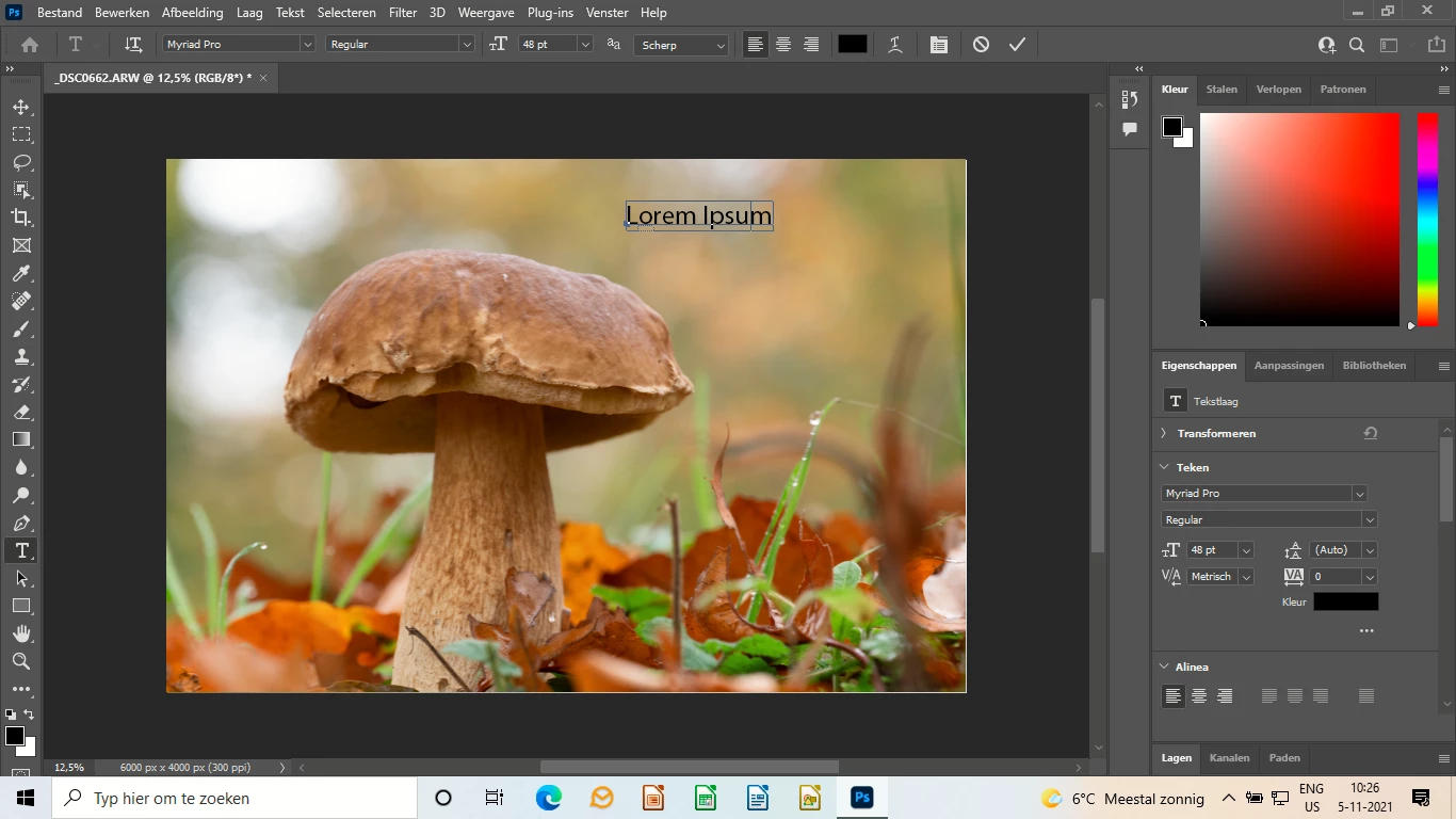

Nov 21, 2021 9:52 AM UTC
