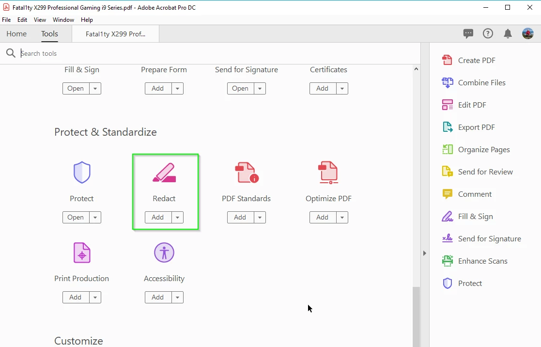

    There are some lassies (edit: lasses?) on the Acrobat forum, Trevor, and we would concur with using the redaction tool in Acrobat for this job.

    Thank you, yes, I did use OCR on them, and how would I use this Redact tool? I am using Adobe Acrobat X Pro that I got with CS6.

    Rick’s Acrobat X Redaction Guide would be specific to your edition of Acrobat.
    Contain through information with screenshots and is part of the Acrolaw blog that Adobe sponsors for legal professionals.

    You are right to be careful. Serious exposures have been made of sensitive material. The best approach is to use Acrobat Pro which has a “redaction” tool.
