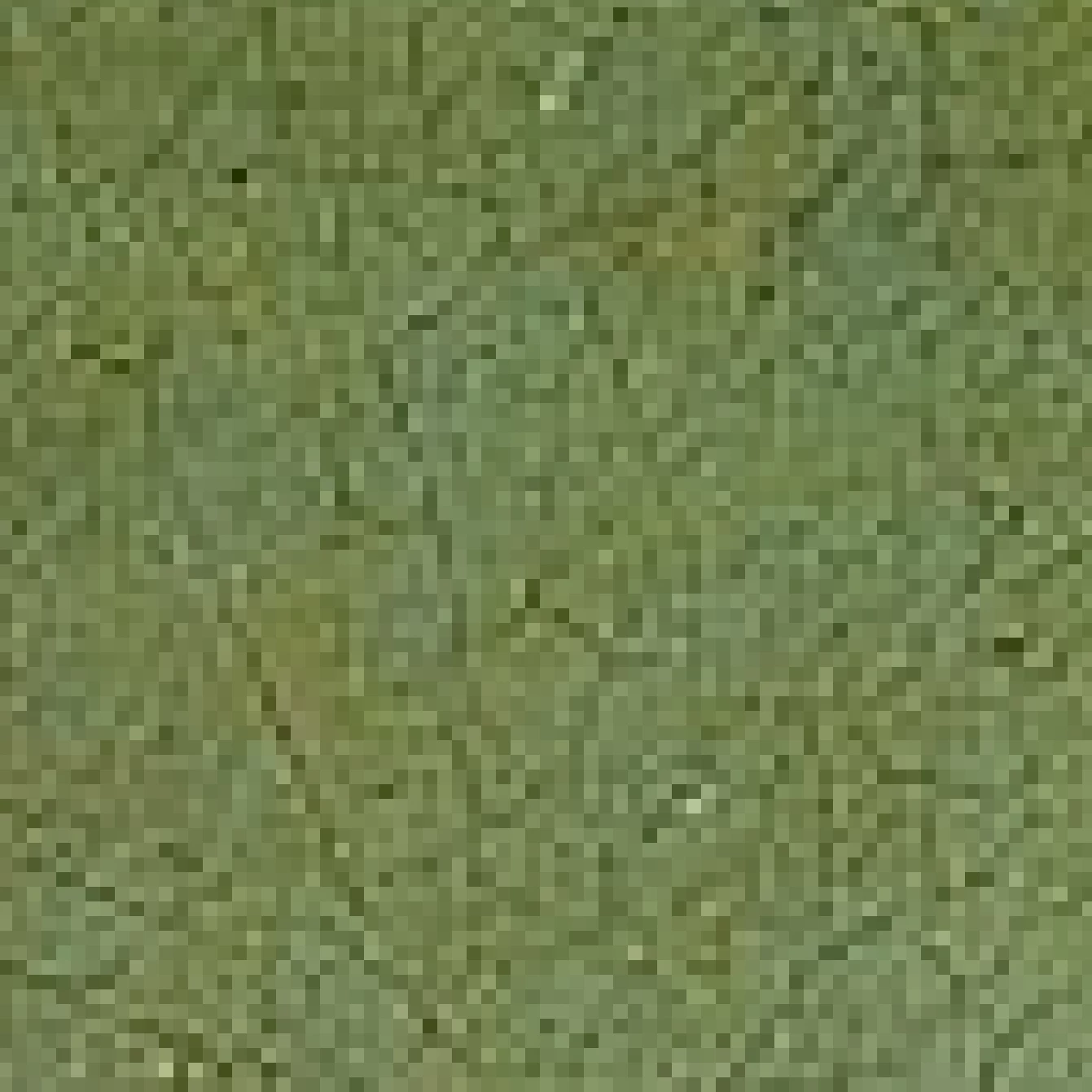

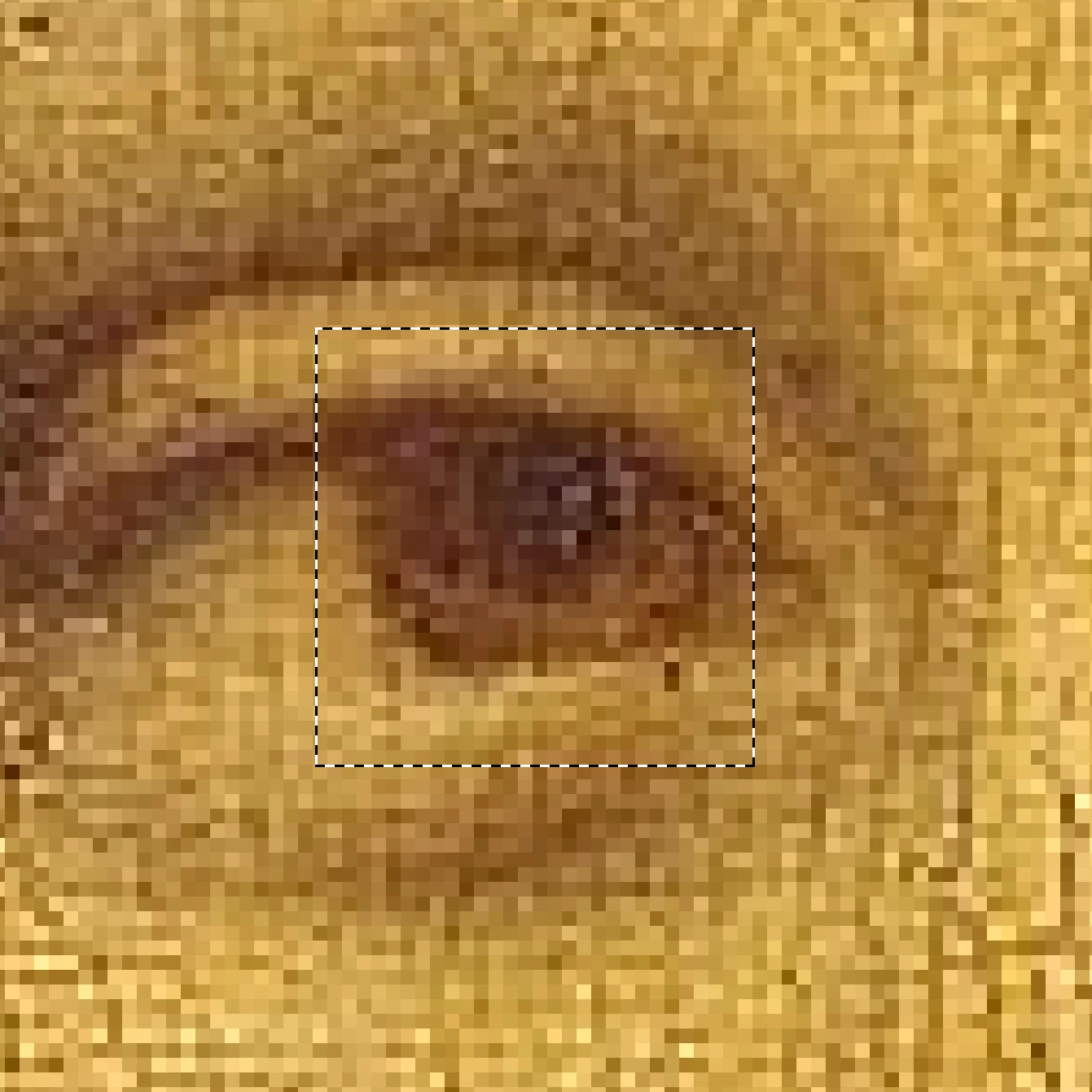

Just want to check with fellow scripters than panning (as in using the hand tool) to move around a zoomed in large image is NOT possible with scripting?
I want to zoom in on a large image and then be able to pan to a selection  - but I don't think there is anything that can help me on this one. Even the navigator doesn't highlight selections.
So go from :
to
Using a zoomed in version of the Mona Lisa an an example
