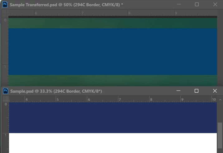

Hi! I'm applying Pantone 294 c to my CMYK file but when I transfer it to another PSD, it turns to another shade of blue.
Can't find the solution for this. I need to establish the Pantone 294 c as a base color for all materials. Attached the file here.
Bottom photo: Main blue with Pantone 294 c using Pantone Connect
Upper photo: Transferred (dragged) but color changed
Thank you in advance!

Do your files have different color profiles?
khamscstll作成者
April 12, 2024
They're both in CMYK 🙂
Michael Bullo
April 12, 2024
Yes but what "flavour" of CMYK?
Choose "Convert to Profile" from the Edit menu and note what the Source Space Profile is. Are they the same for both files? Choose Cancel to dismiss this dialog box without making a change.
