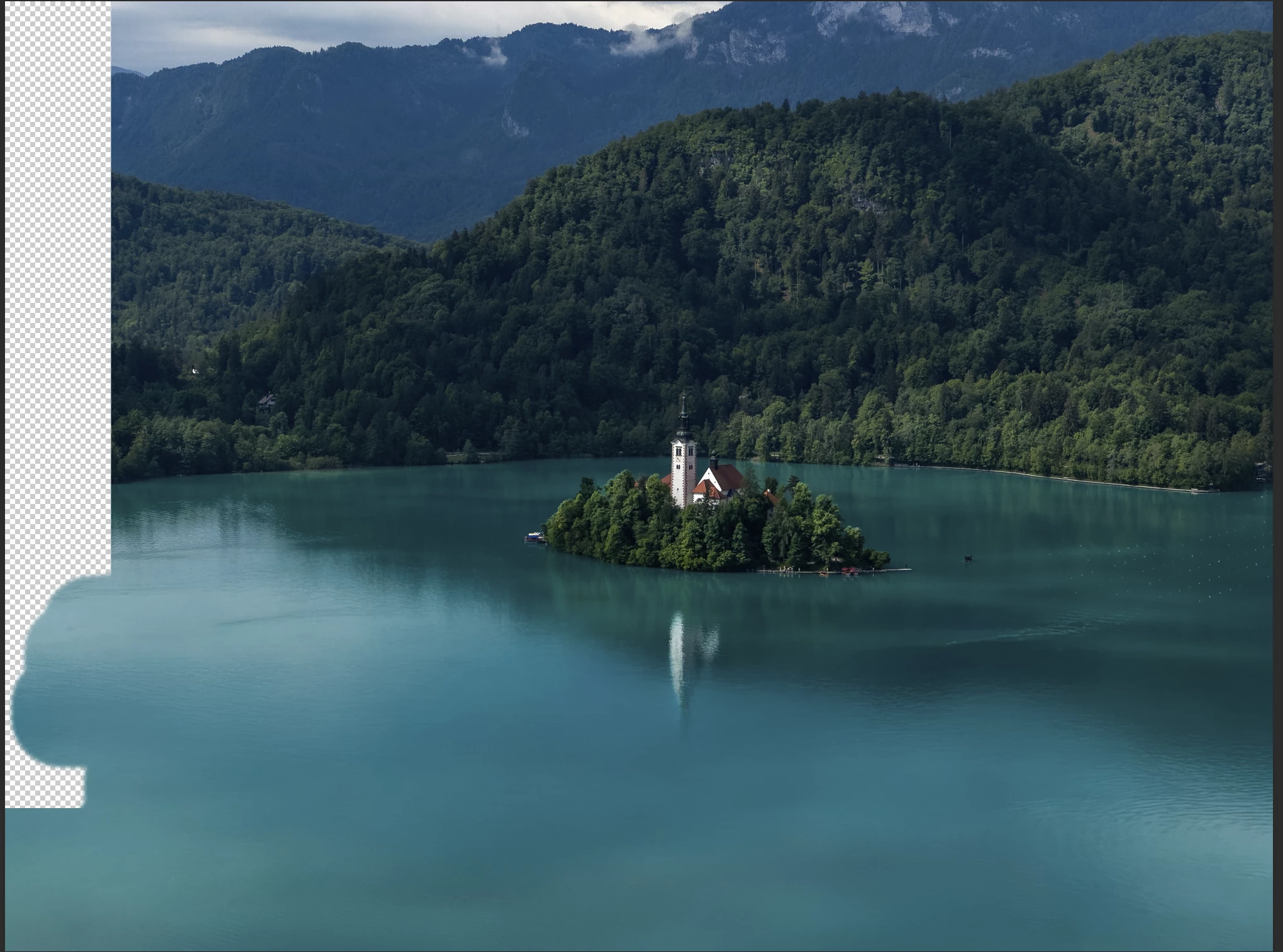

A partial layer appears in my Photoshop image after modifying a smart object image in camera raw following the addition of a mask layer.  The new partial layer appears when I return from camera raw to Photoshop. This problem just started a few days ago.  I have tried numerous techniques like double clicking on the camera raw icon, but the problem persists.  Your solution to this problem is greatly appreciated.

    What you’re seeing on the left side is transparency (the checkerboard area), rather than a separate partial layer. Since it appears only after you modify a mask in Camera Raw and return to Photoshop, I’d like to narrow down whether this is related to the Camera Raw mask/rendering process.

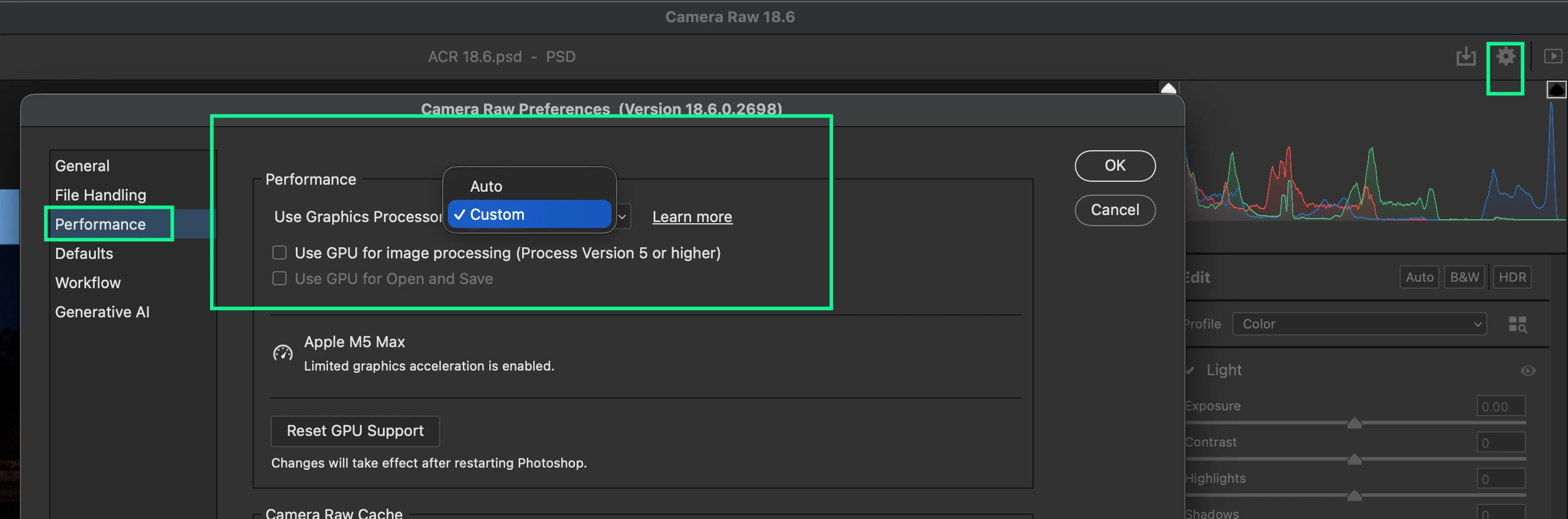

    4. In Camera Raw, temporarily uncheck all GPU acceleration settings under Preferences (Gear Icon) > Performance, restart Photoshop, and repeat the test.

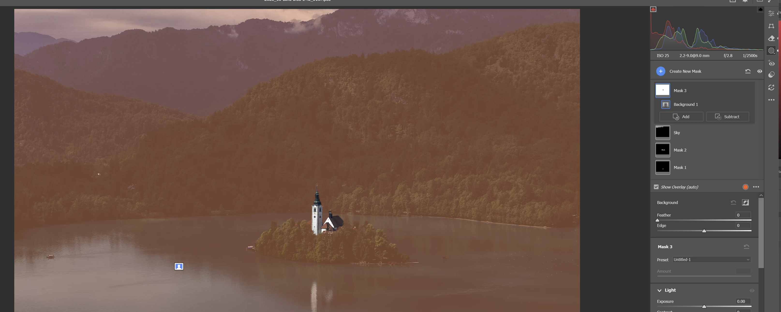

    Aug 22, 2026 4:38 PM UTC
    The problem arises after I create a new mask layer and return from camera raw to Photoshop.

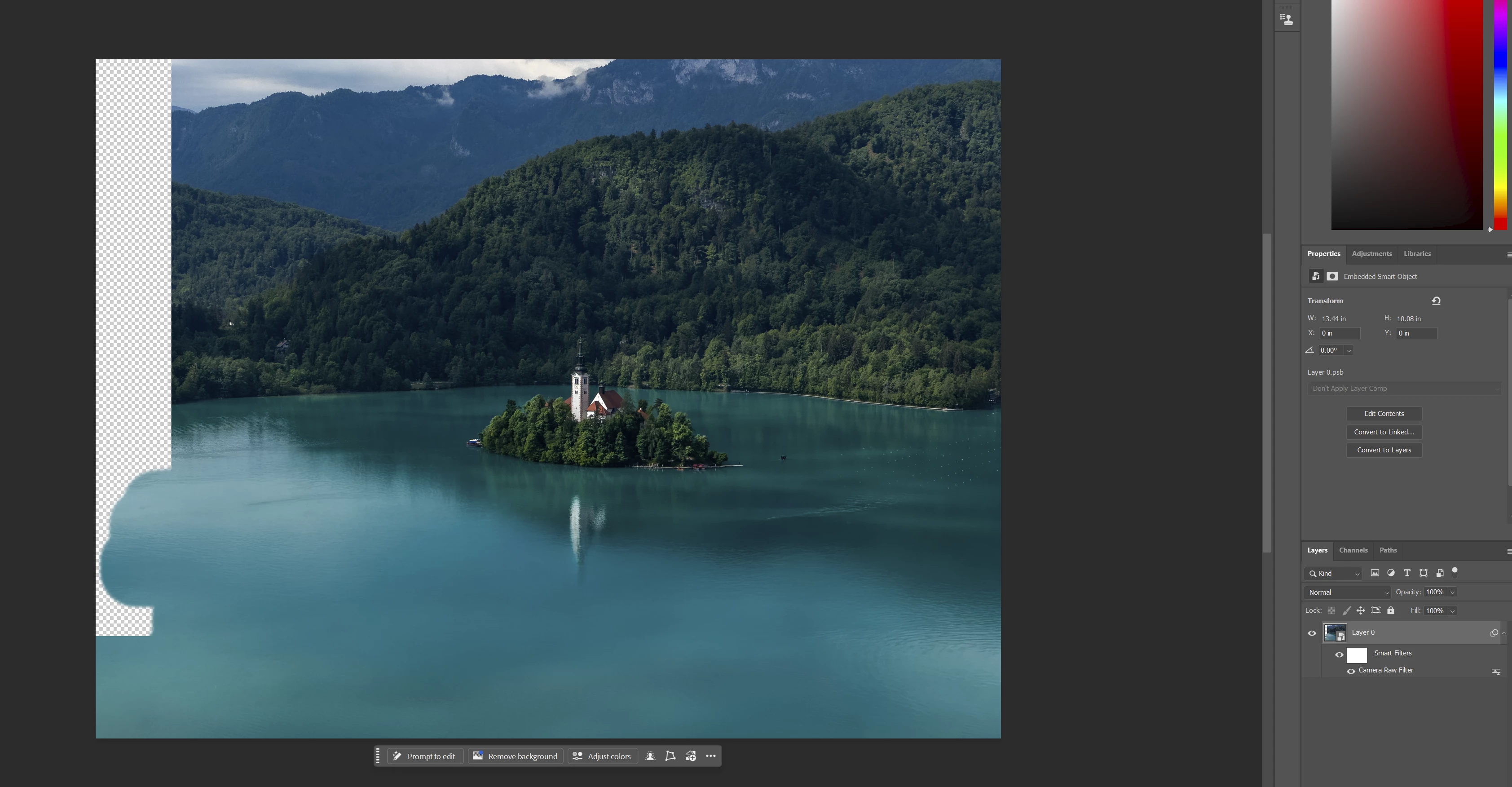

    Aug 22, 2026 3:47 AM UTC
    Trevor.Dennis
    Aug 22, 2026 5:30 AM UTC
    Unfortunately, that doesn’t show us anything.  We need the full workspace with layers panel visible.  It needs to be full-res and with the problem layer selected.
