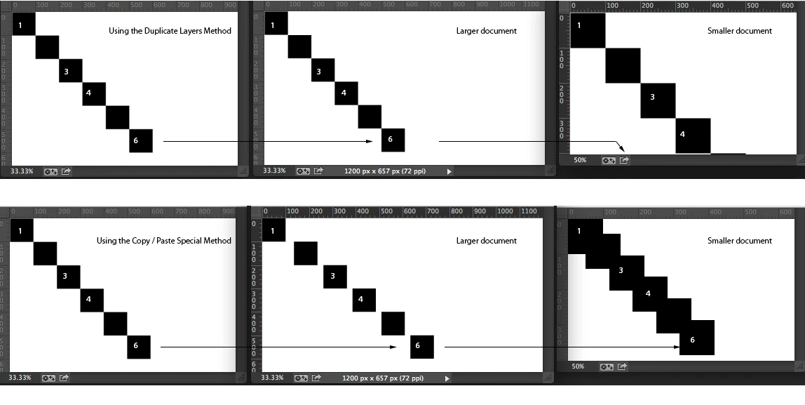

    Target the layer you want to move, then from the menu:
    Layer > Duplicate layer...
    In the dialog box, select the document you want to paste into. The positon will be the same even if the document is larger or smaller.
    You can also rght click on the layer and choose Duplicate Layer...
    This is almost the same as Paste in Place (Edit > Paste Special > Paste in place) One difference being you dont have to make any selections nor do you have to switch documents to complete the paste. So you can work from multiple documents duplicating a layer or layers into a document thats not taking your focus.
    A second difference is the duplicate layer method preserves the relationship between layers while paste preserves the relationship of the layer relative to the document size.
    All positions are relative to the upper left. So if your receiving document is smaller and you paste an object that resides lower right in a larger document then it may appear off screen.

    I like this Duplicate Layer (or Duplicate Group) function.
    At least when you are transfering elements from one file to another that are not the same size, the duplicate layer function puts the duplicated item essentially where it was in the original document.
    (Is it using an x-y coordinate from the 0-0 point?)
    I rechecked, and yes if the two documents are exactly the same dimension, then a shift-drag of the layer does place the transfered layer in the exact same location in the new document as in the original document.
