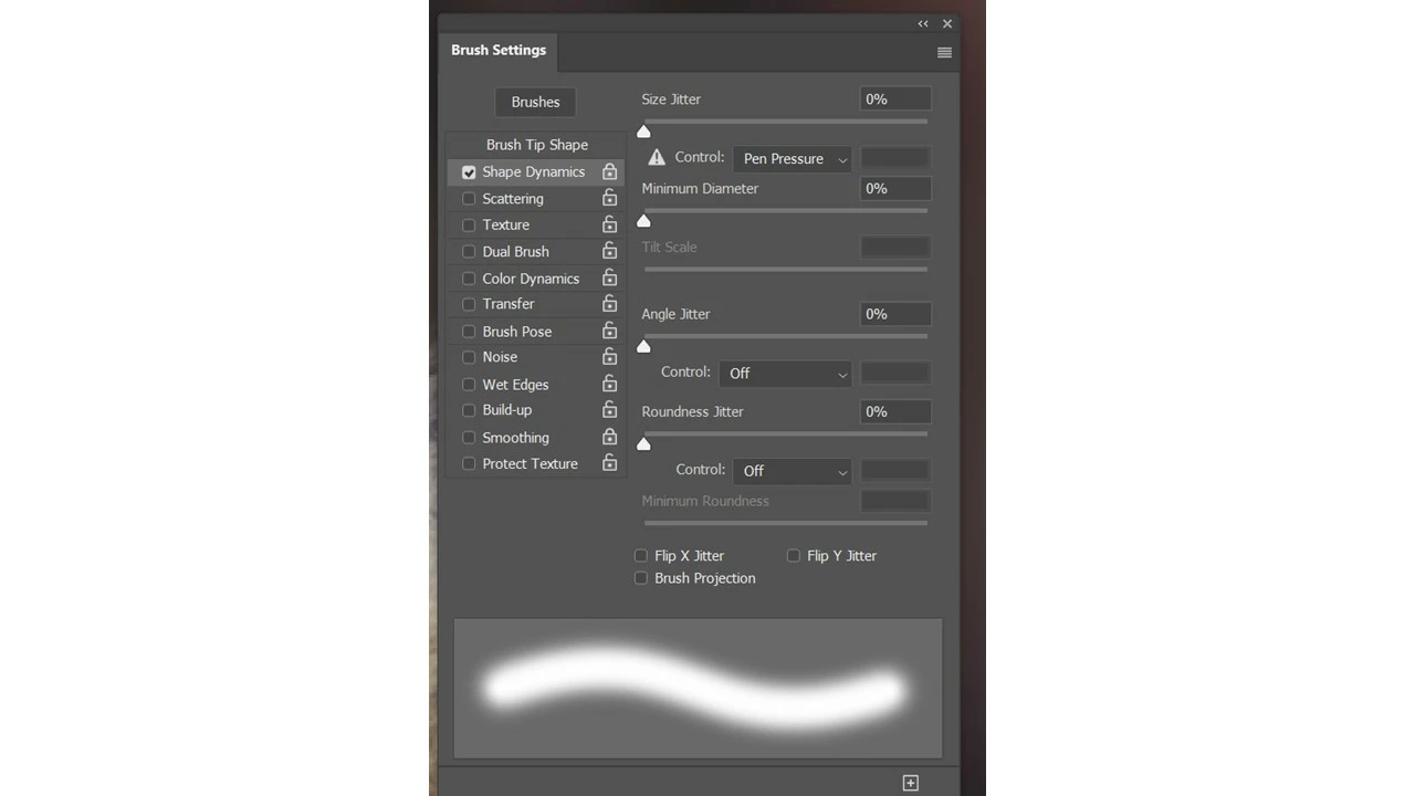

I would appreciated if you could help me . I am trying to customise a brush in PS CC 2025 for hair strands that pointed rather rounded at each end. In brush settings, I am getting a triangle waring - see attached screenshot. Also attached the brush line that I am getting- see screen shot.  I have looked to some previous discussion, although they go back to 10 years ago, and watched a few YouTube videos . This wahet I have done so far.
Inserted a text in PS cc 2025 setting  - see attached text Ticked and unticked window in box in Wacom setting.
Just 2 days ago , after I have done all above , the brush setting worked but now I went back to square one.

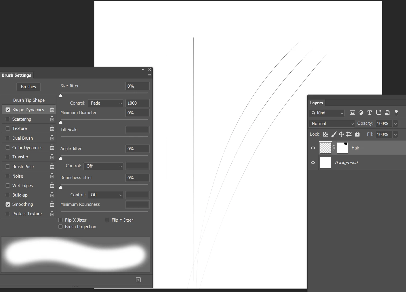

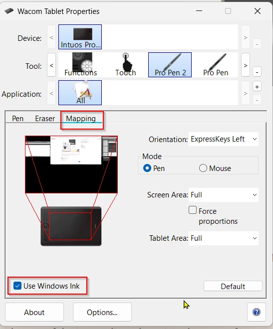

Windows Ink has been the preferred API for a number of years now.  I would rename the psuserconfig.txt or move it to another folder, and check Windows Ink in Wacom properties.
I use Fade for single hair strands, but I think you'll get better results with a fully hard brush, it looks like you are using a fully soft brush).
Set spacing to 5% and use a Fade vale of something like 500 — 1000
This is with a 1000 pixel square canvas, brush spacing 5%, one pixel fully hard brush.  I also like to use a layer mask and soften the start of the stroke with a soft brush
You can make a hair preset by sampling some random dots (this is zoomed to 200%).  I would actually copy the layer and set it to Multiply. Then merge the two layers before sampling (Edit > Define Brush Preset). Note that the dots do not align vertically. If they did you'd get darker strands where two dots overlapped vertically.
That gives you a stroke like this, with Fade set to 750 (1000 pixel canvas)
