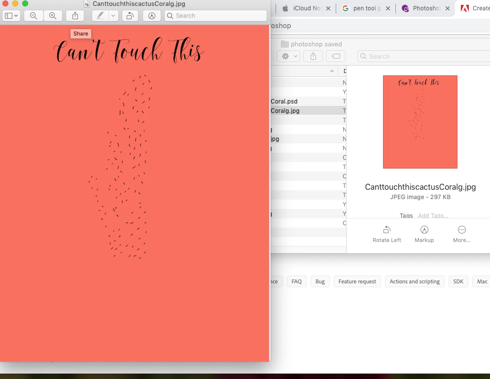

Pen tool drawing disappearing when save to jpeg
So for the second time i drew something with the pen tool. It was on a seperate layer from the background colour. I saved the file as a jpeg and when i went back to open it, the entire pen drawing was gone. In a seperate layer i had added some tecture with the brush tool, this is the only thing that remained from the image i drew. why is this happening? when I go to look at the jpeg the image is missing. Heres a screen shot for reference

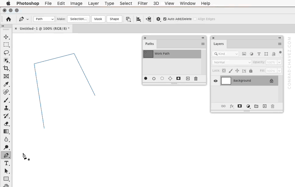

Sorry it took a while to reply. I thought I knew how to solve this by converting it to a shape layer, but it would end up filled and closed. I finally figured out how to make it unfilled and open, so the solution is in the animation below. Does it solve your problem?
A shape layer can be printed or exported, so once you get it there, that should take care of things.
In the future, if you want a path to be drawn as a shape layer, be sure the tool is set to Shape in the options bar before you begin drawing.
More notes:
  • After you convert the path into a shape layer, you can delete your original "cactus" path.
  • If the animation is confusing, pay attention to what is happening in the Paths and Layers panels at each step.
  • The Color Fill layer is the name of the new shape layer. You might want to rename it so that you remember that you're not really using it as a color fill, but as a vector shape layer.

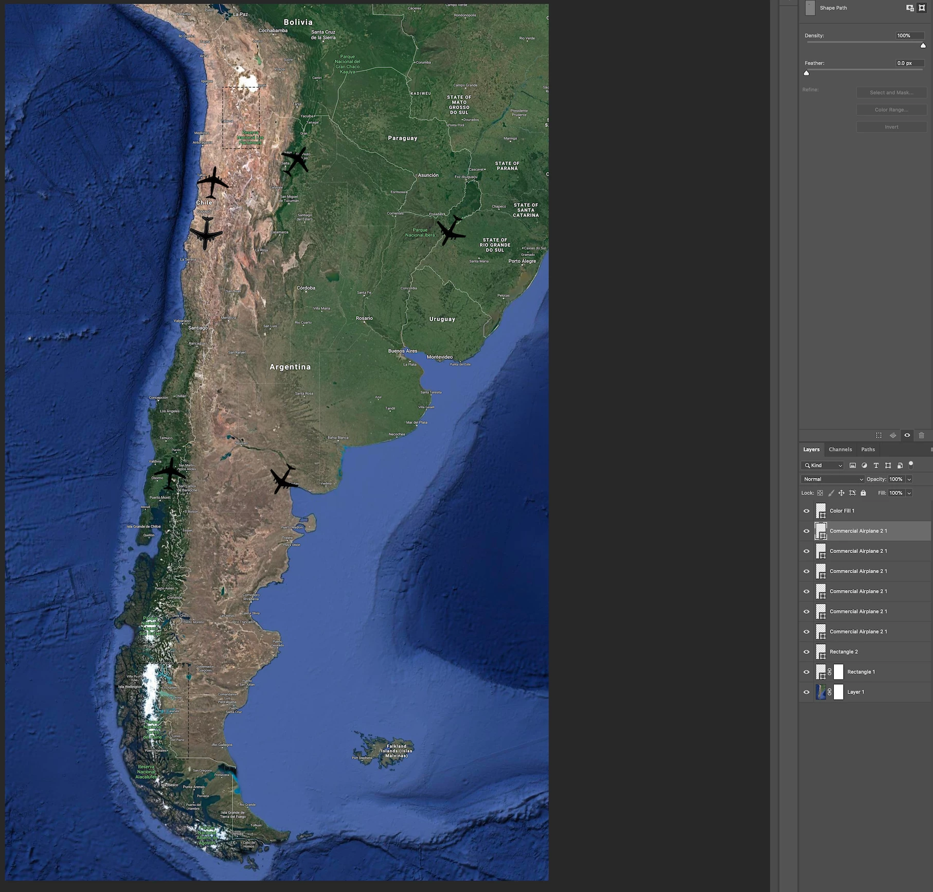

Hello, I tried this but even when the path are now a layer they only when the layer is marked. When I deselect the layer the paths are no longer visible. They disappear when I convert to JPEG. See attached screenshots.
Conrad_C
May 14, 2020 11:20 PM UTC

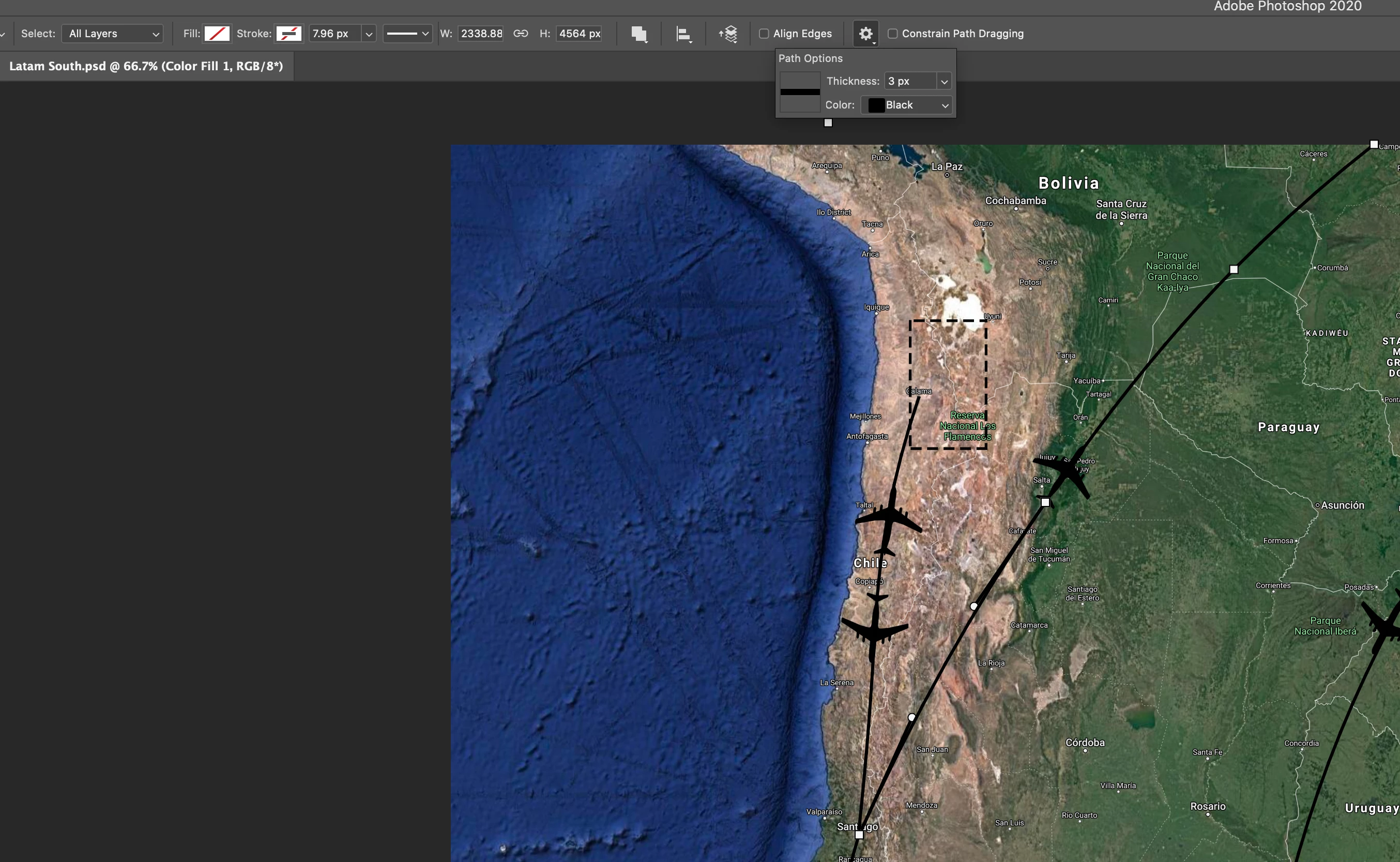

What Fill color and Stroke color/weight settings are applied to the shape layers?
If they disappear when the layer is deselected, that indicates the shape layer might not have a Stroke weight or color applied to it.
(I traveled on some of those airline routes many years ago!)
May 15, 2020 10:29 AM UTC
Nice to hear that you have been to these places! I have selected one of the paths and it shows black color and thickness of 3pxls. I have also made sure that all the shapes are brought to the front so that they are not accidentally hidden behind other layer. But the problem is still the same. Screenshot below.

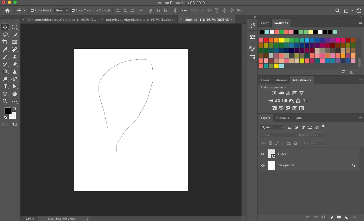

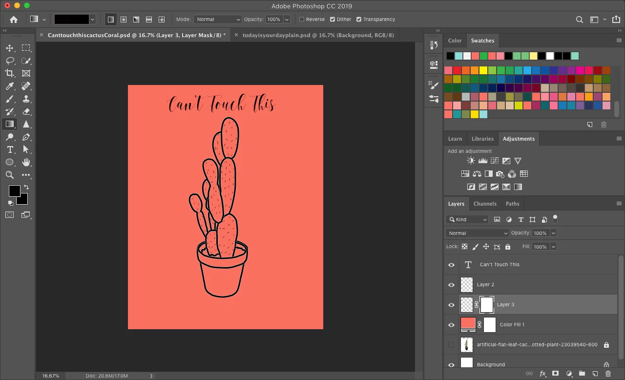

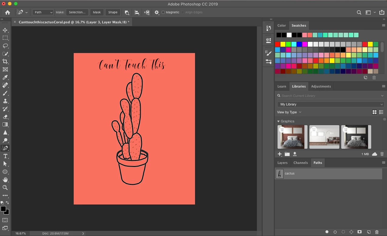

Nov 12, 2019 1:08 AM UTC
The options bar shows that the Pen tool is currently set to Path. That means the path might exist only as a path and not a shape layer. If it isn't a layer, it won't print or export. Can you show your Layers panel so we can see if the path is available for export to JPEG?

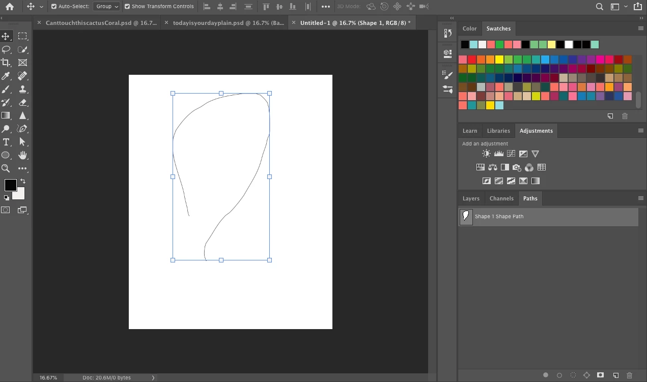

Nov 12, 2019 5:52 PM UTC
here is a photo of my layers panel. Is there a way to move the drawing from "path" into "layers" without loosing the image when i save it? or is there a way to convert that path into a shape to transfer it to a layer? I did a test and switched to "shape" when using the pen and saved it and the image came showed up, however as you will see in the second and third photo the shape isnt showing up in the layer, only shows up in the path. is that supposed to happen?
Also how do i save a path drawing for future use and ensure it comes up in the layer so i can print it as a jpeg.
Thanks for all your help, im new to adobe spent many hours trying to figure this out 😞
