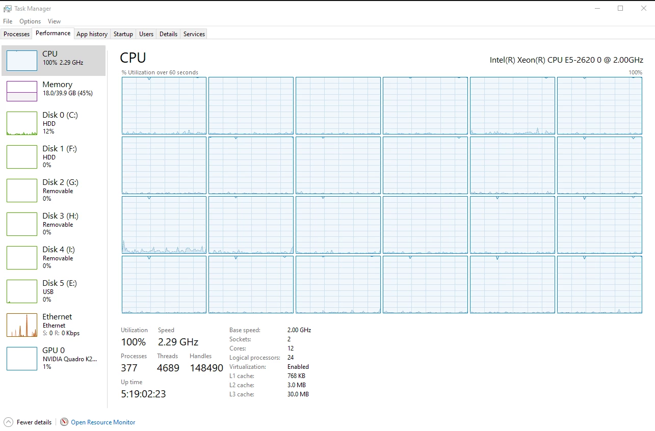

Some Filters are quit compute intensive. Even when multiple threads that can take time to do their processing.  My machine is old and slow. Compare to yours.  It is all I need. It has 2 slow 2 GHz Xeon six core Processors, 40GB of ECC Ram and a small 256 GB SSD.  All  data file are on  external USB 3 disk.  System, Application, Appdata, Paging and Scratch is on the SSD.  There around 120 GB of free space for scratch.
I just create a new document  30,000 x 30,000 8 Bit RGB color.   I added the max amount of noise to the white canvas.  Took little to no time.   Now I know surface blur is compute intensive so I started  Surface blurt with it max settings to time it and look at the Task Manager. All thtat was active on the machine was Chrome which I was not playing with, Adobe Photoshop 21.2.3 surface blur and the Task Manager.  Here is What I saw in the Task Manager.
100% CPU, half memory utilized Photoshop can user 90%,  6% SSD Photoshop was using some scratch space. It took my machine 12+minuets to perform the surface blur,   All 24 core were flat lined.

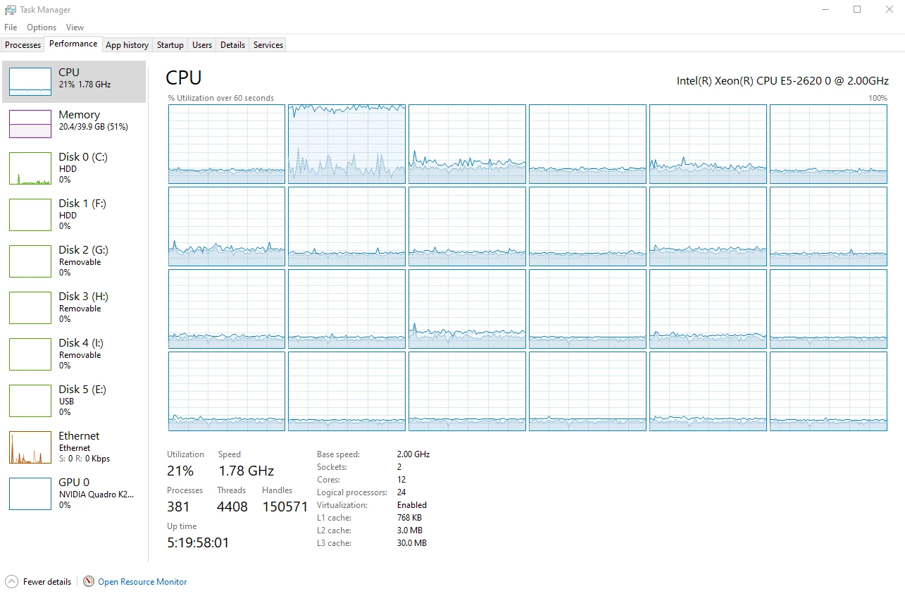

September 22, 2020
Core speed is more important then many core. Here you see Photoshop Smart Sharpen Filter took nearly 3 minuets.   Again the bottleneck is  processor.  through my 6 cores are running 24 threads the CPU utilization is 21%.  However it one task of the 24 holding things up. Ram usage when up some.
