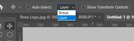

I used to be able to click on a folder of grouped layers and move that entire group at once
By @kristinisyourbff
If you use the drop down to the right of Auto-Select you have the option of choosing just the layer you are selecting or the group it is contained in (if it is in a group).  Do you know that if you turn off Auto-Select you can temporarily re-enable it by holding down the Ctrl/Cmd key.  That has always been my preferred way of working.

@jane-e wrote:
If you have AutoSelect enabled in the options bar for the Move tool, then uncheck it to see if that solves it.
Jane

January 4, 2021
~ Jane
