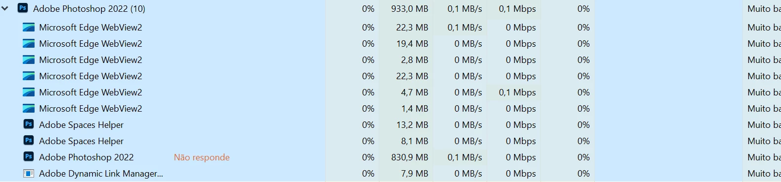

i saw that post too, but even though has some similarities to my issue. My photoshop freezes everytime i open it, not only when i do it trough lightroom ! it allows to go to preferences, after a few seconds does not matter what i do it freezes. i send a screenshot of the task manager showing what happens there ! hopefully we can solve this issue fast, have some work to do !
