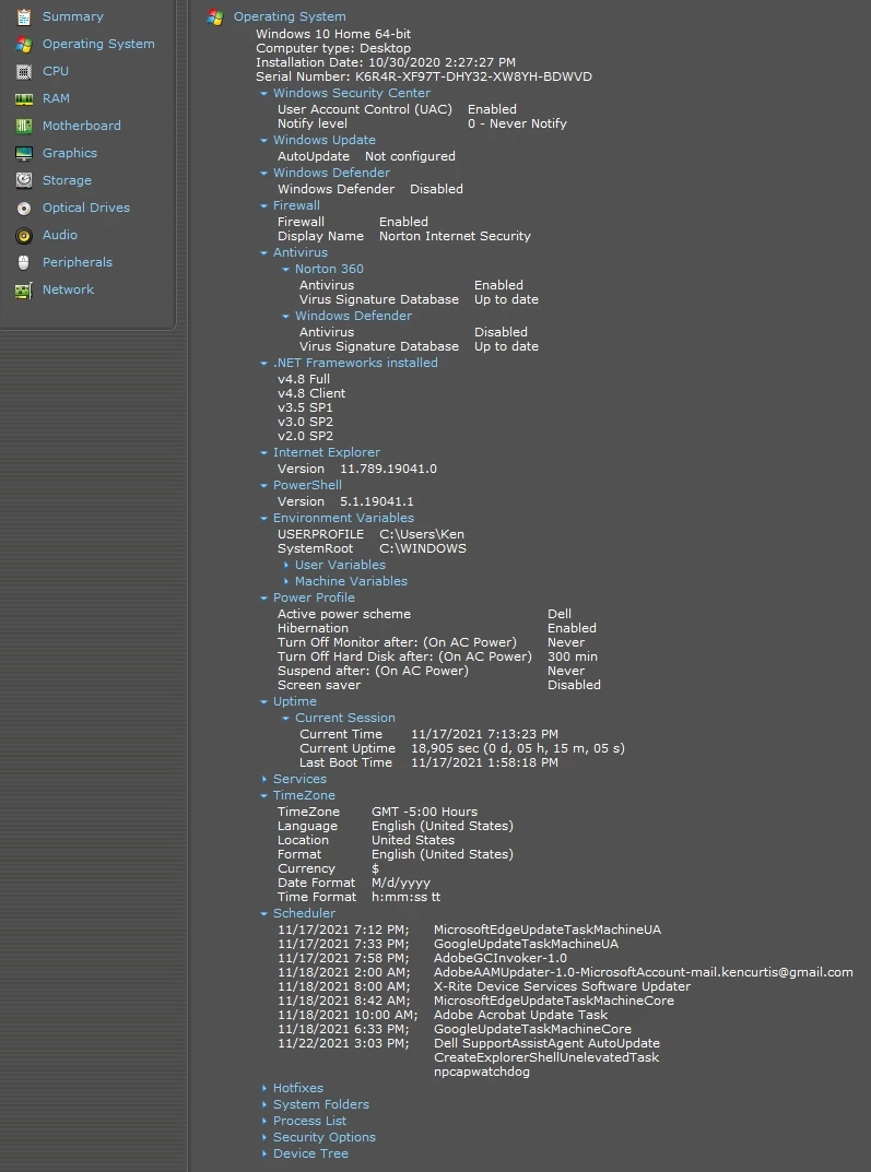

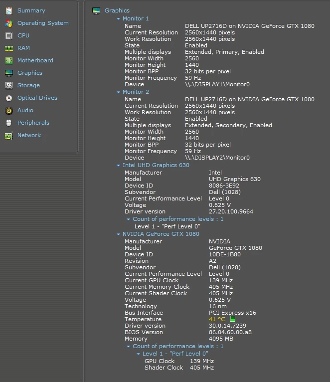

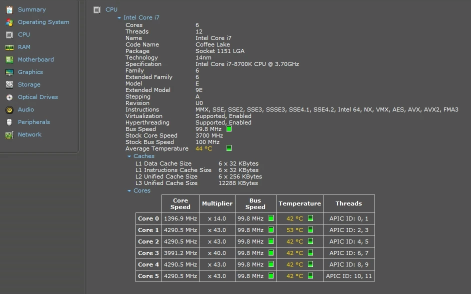

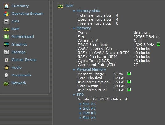

The belowis from right-clicking This PC using Windows Explorer.The images are from a program name Speccy.
Device name Giraffe
Processor Intel(R) Core(TM) i7-8700K CPU @ 3.70GHz 3.70 GHz
Installed RAM 32.0 GB (31.8 GB usable)
Device ID 17D8A3E6-E042-4B65-ACAA-CFBA9AE6CDA6
Product ID 00325-80184-96206-AAOEM
System type 64-bit operating system, x64-based processor
Pen and touch No pen or touch input is available for this display
Dramenon
November 18, 2021
Greetings Ken,
Would like to gather more info and see if we can to the bottom of this...
Would you mind providing the Device specifications?
  1. Right-Click My Computer
  2. Copy the Device specifications or a screen shot
  3. attach to this thread.
Or run dxdiag.exe from the start menu and copy the System information.

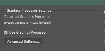

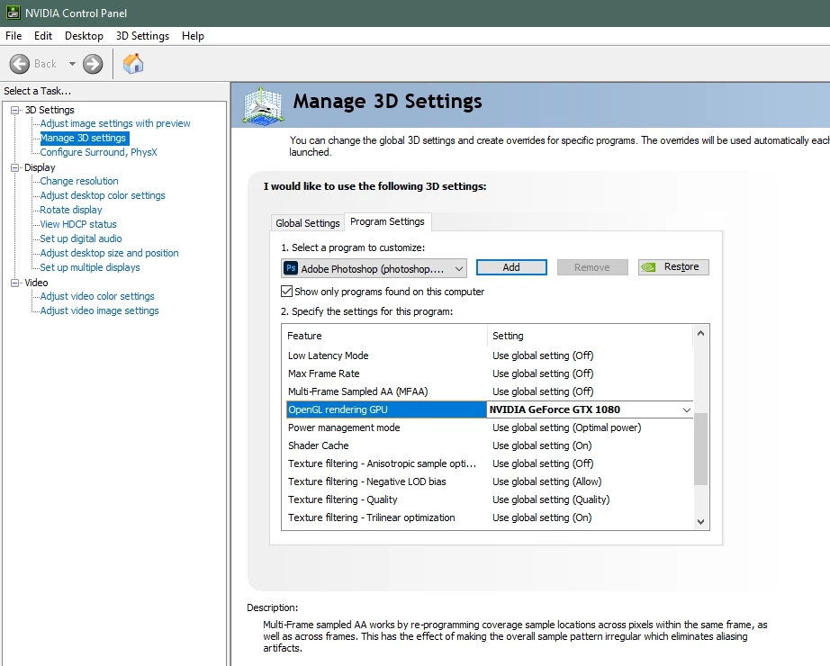

I thought I posted a reply. Just in case something went wrong, here it is again. I added Photoshop and Sniffer and changed the setting for OpenGL rendering GPU to my NVidia card. I also followed step 8 and disabled the lesser graphics processor in Windows Device manager.
Here are two screen shots.
November 16, 2021
I had to add Photoshop and Sniffer to the list. I changed the settings for OpenGL rendering to NVIDIA GeForce GTX 1080. The settings in Photoshop were already set to the NVidia card before the change. I also followed step 8 in the link you provided and using Windows Device Manager, disabled the onboard, less powerful graphics processor. I included two images for you to view.
November 16, 2021
I notice you have two cards. Try step 7 from the troubleshooting steps here to set NVIDIA card as the primary high performance card: https://helpx.adobe.com/photoshop/kb/troubleshoot-gpu-graphics-card.html
