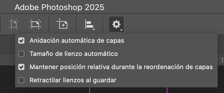

I found the "solution"!!!
If you turn OFF [Auto-size Canvas] option, then there is no more freezing/hanging.
The only side-effect is the canvas size. It stays as is, so if you try to move an artboard out of the canvas, then it will be "hidden".
But the easiest way is to make two empty artboards (when [Auto-size Canvas] is on) and put these to the top left and bottom right corner of the "needed" canvas and then turn OFF the [Auto-size Canvas] option.
Edit: if you move an artboard out of canvas (because you need more space), and it is hidden, you need to turn back ON Auto-size Canvas just once, then every artboard will be on that resized canvas, and you can switch back OFF, and there is no more hanging again

February 3, 2025
Someone on another forum found a temporary solution.
The problem seems to be in the size of the sector.
When you create a new artboard the size of the sector changes.
and that change consumes a lot of resources.
so what I do is when I create a new file.
I create many empty work tables. With this, the size of the sector is expanded with empty tables, which does not require as many resources.
Then I disabled the "automatic canvas size" option.
When you do that you will realize that whether you create or delete new work tables, the size of the sector does not change.
and as a result. They move super fluid.
Be careful, don't leave the sector, because you can't work outside of it.
If you want to see the sector, you must enter the "view" "show" "sector" tab
January 23, 2025
i find out the most effected way is close this on he canvas setting

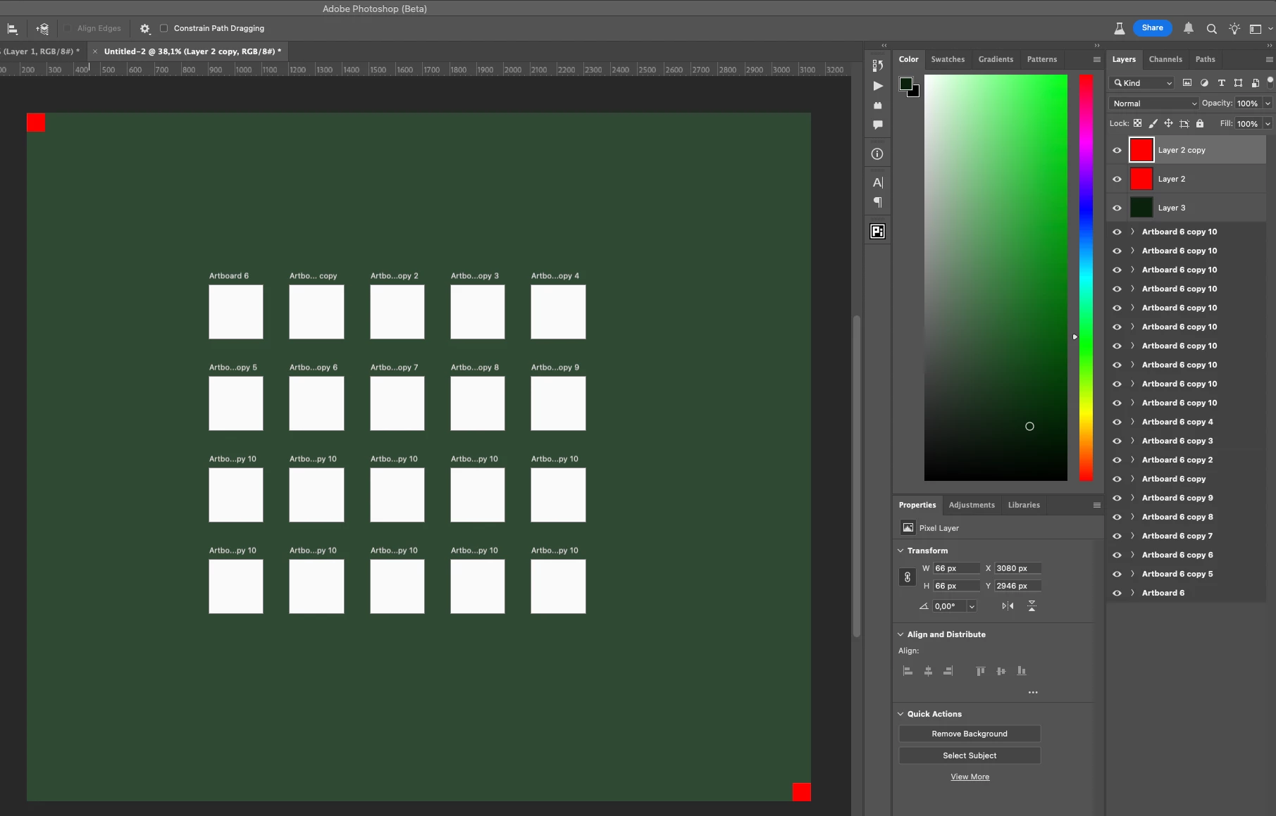

benjaminb67729647
January 20, 2025
For me it works when i make bigger canvas. I force it with positioning 2 seperate layers on top left and bottom right corrner.
After that you can position artboards in between layers.
When you need bigger canvas just move outer layer first to makes canvas bigger and than make/copy/drag artboards in between that area.

benjaminb67729647
January 14, 2025
sometimes i just put 1 white layer like 10-100px big on top left and on bottom right corner so the canvas is bigger. but still that is not a fix 😕😕
