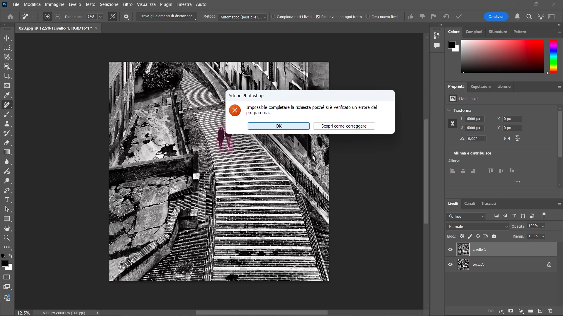

Hello
Since the last Camera Raw 17.4.2. 2283 and Photoshop 26.9.0 on a PC with Windows 11 I have  the following problems:
While using the buffer tool I got the following message: unable to perform this operation due to a program error. I get the same message with the delete tool
In a second time, Photoshop crashed. L
Neural filters have also been greyed out since then.
I restarted Photoshop and the computer: No improvements, the problems persist.
I reinstalled Photoshop but nothing helps, I still have the same bugs.
Thank you in advance for your help.

Aug 8, 2025 11:34 AM UTC
App version: Photoshop 26.9
Platform: Windows 11 (64-bit)
GPU drivers: Up to date
Steps to reproduce the issue:
-Open any image (RGB, 8 or 16 bit)
-Select the Remove Tool
-Paint over an area
-The tool crashes with the error:
“Could not complete the request because of a program error.”
The Remove Tool used to work perfectly in Photoshop 26.8.1, and I’ve confirmed that going back to that version solves the problem.
What I tried:
– Reset all tools
– Unlocked all layers
– Tested with rasterized layers and new documents
– Disabled GPU acceleration
– Reset Photoshop preferences
– Full reinstall
– Whitelisted Creative Cloud and Photoshop in the firewall
Expected result: Area should be removed using content-aware algorithm
Actual result: Tool crashes with a program error
Can anyone help me solve this problem?
Thanks
