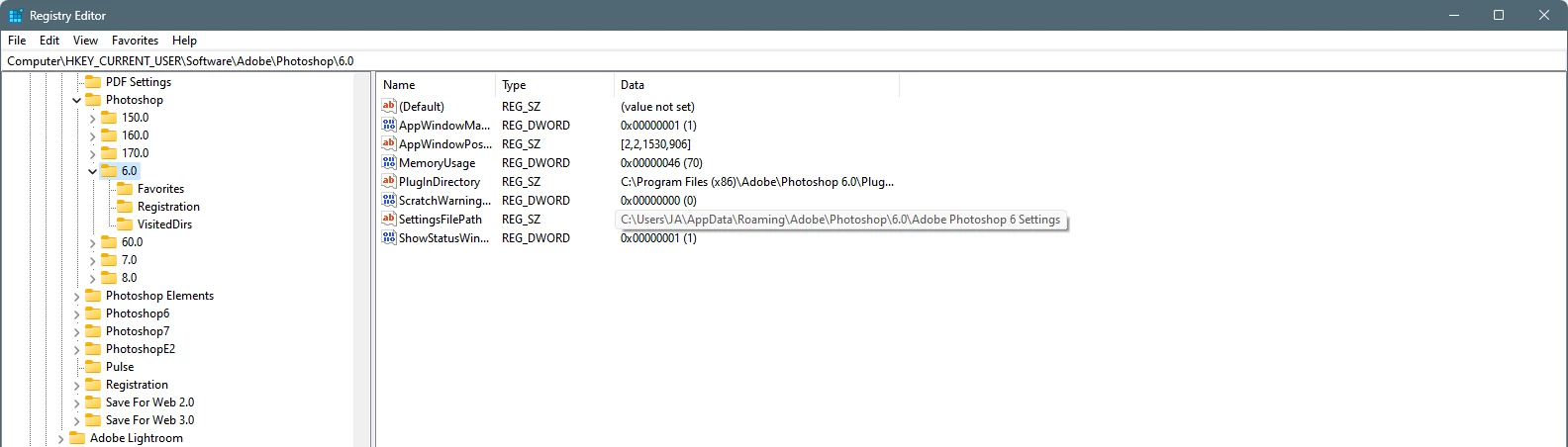

1-Aller dans le registre de win 10 : regedit
2-Supprimer la clé Adobe/Photoshop/6.0/SettingsFilePath (6.0 pour ma version)
3-Lancer Photoshop
4-Faites ça à chaque lancement de Photoshop

Jul 14, 2023 5:16 AM UTC
Michael Csikos,
That's interesting about the SettingsFilePath in HKCU\SOFTWARE\Adobe\Photoshop\6.0
I have both Windows 10 and Windows 11 with phortoshop 6.0.1 and did have the “Unable to continue because of a hardware or system error. Sorry, but this error is unrecoverable.” briefly, but went on away after another update on both systems, though i couldn't say for sure why photoshop 6.0.1 started working again with no compatibility mode required.
Anyway it might of use to see if there is a difference in the SettingsFilePath between a system with the error and without the error.
This is on Windows 11 x64 22H2 (OS Build 22621.1992)

Jul 2, 2025 1:45 PM UTC
3-Lancer Photoshop
