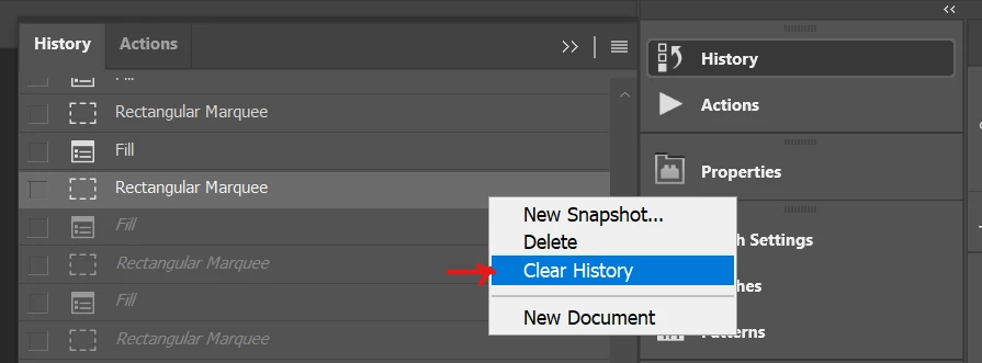

ThioJoe
Mar 25, 2025 4:21 PM UTC
Does clearing the undo history restore the speed? If that helps at least it's a starting point for things to try next to optimize.
I've found for large images especially that it can get progressively more bogged down until doing this at some interval.
