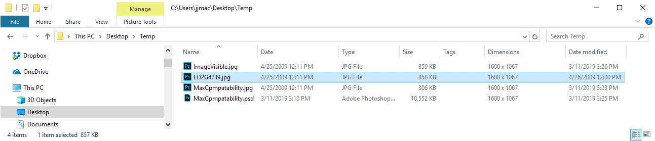

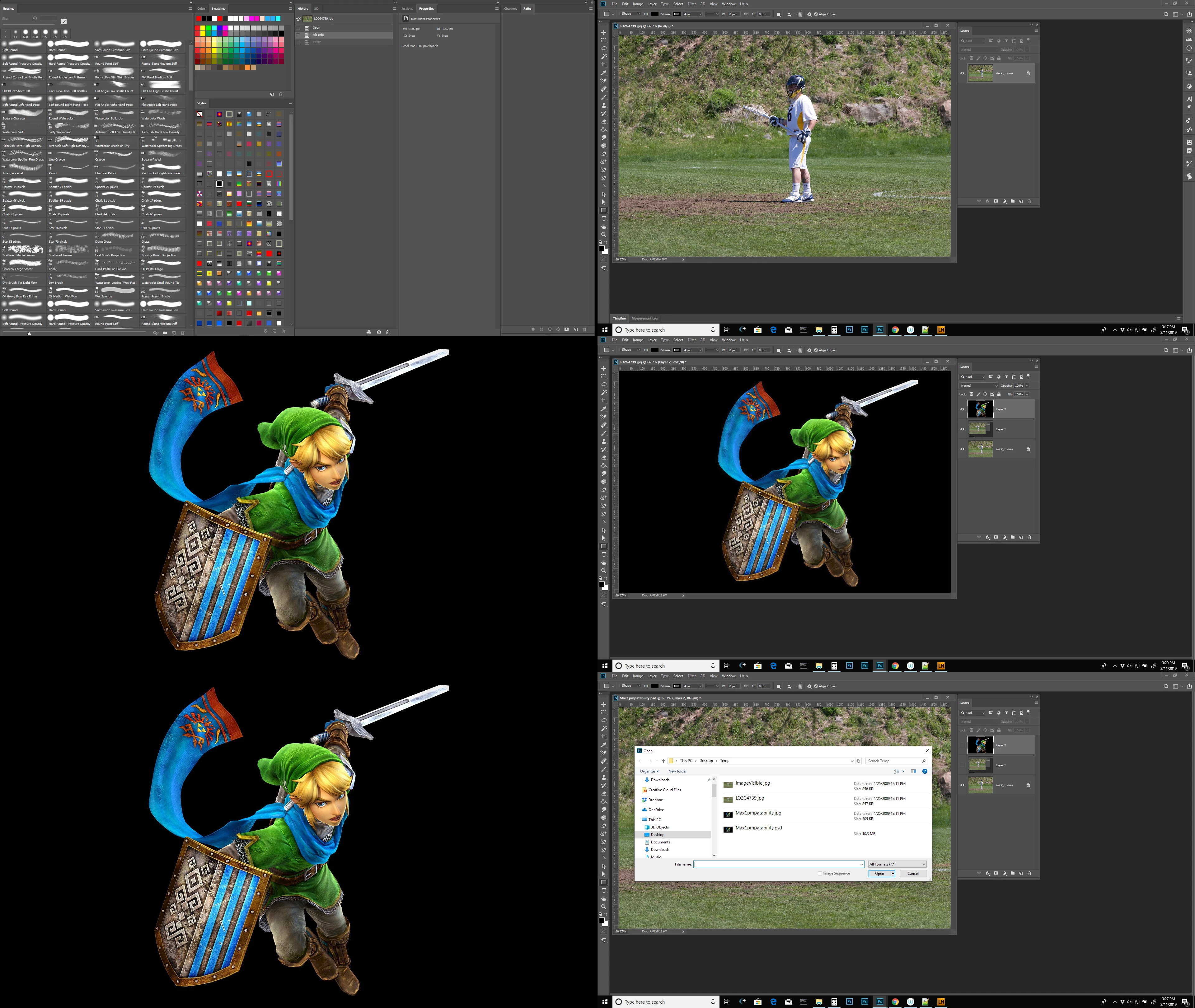

    I copyied a 858KB Jpeg to a temp folder on my desktop and open it into Photoshop  then pasted two screen caprure onto the image. The image is onle 1600x1067 Pixels my screens are larger 1920x1080 so the pasted in layers are larger than canvas size so clipped by the canvas size.
    I saved a layered PSD my preference is  PSD Max compatibility. The saved file size is a 10MB PSD.  I then saved a Jpeg file quality 10. Its size was 306KB, 500KB smaller then the original Jpeg.  I then turn the visibility of the pasted in layers off  and save a second jpeg quality 10. It was once again  858KB give or take the years between the two saves and different Photoshop versions.  I never save PDF file using Photoshop.
