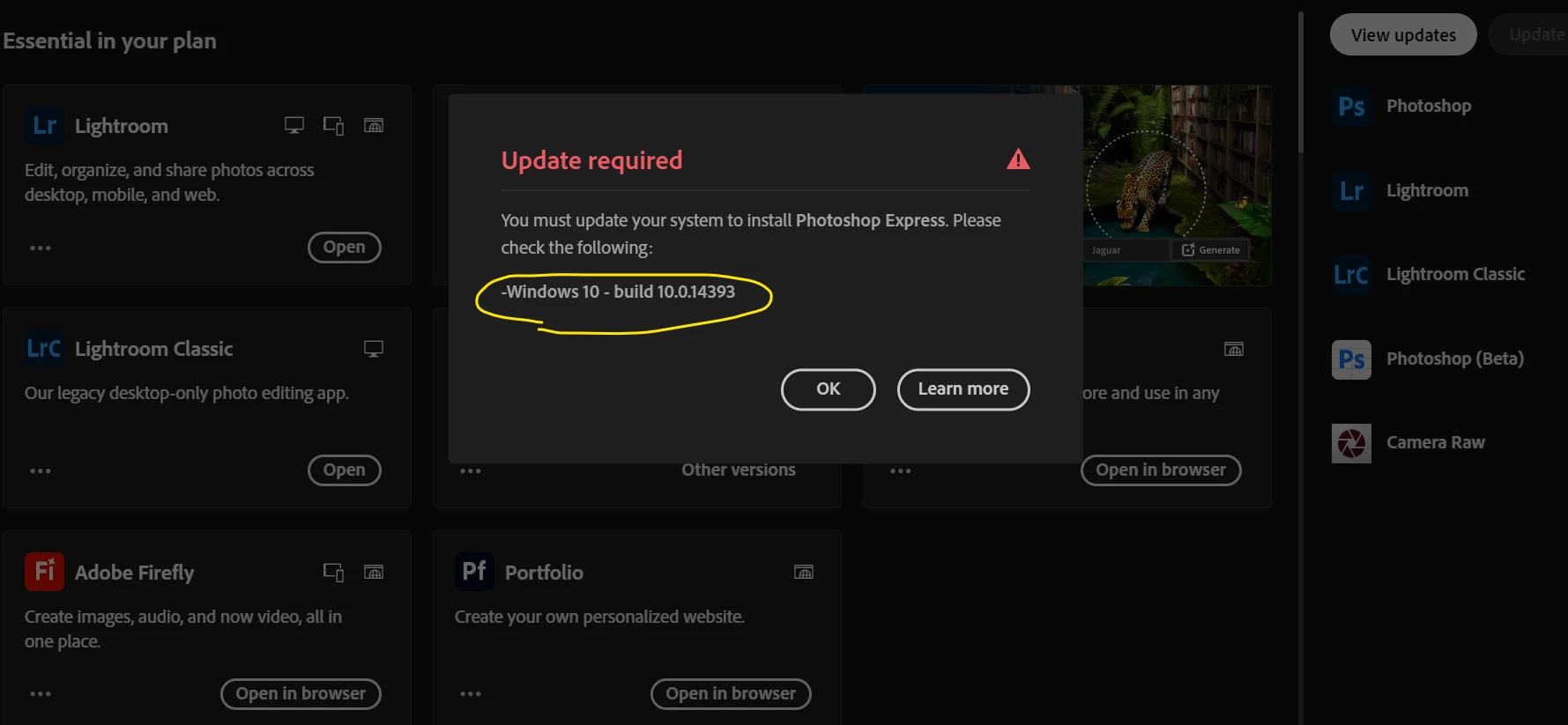

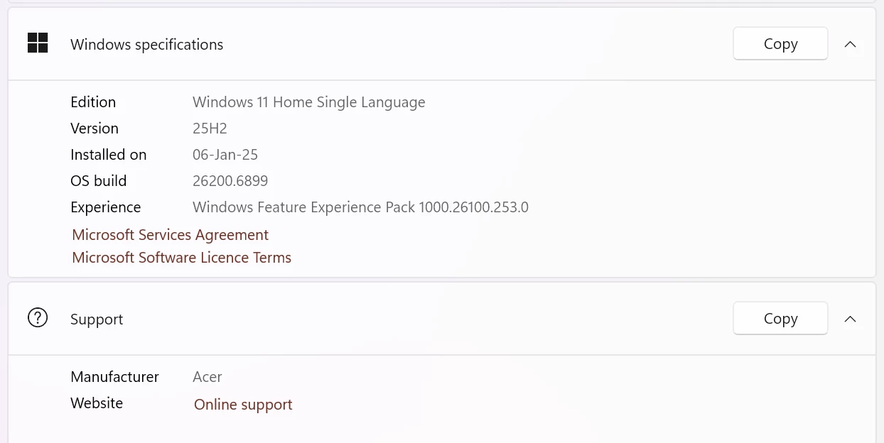

Another thing worth noting is that, from Creative Cloud Desktop, when hovering to Photoshop Express, it says "You must update your system to install Photoshop EXPRESS. Please check the following: Windows 10 build 10.0.14393", but I'm using Windows 11 with RTX 3050 4GB.

The other issue concerning Photoshop Express saying i must update my system to install Photoshop Express.
Adobe Creative Cloud still sees my laptop as Windows 10 instead of Windows 11.
