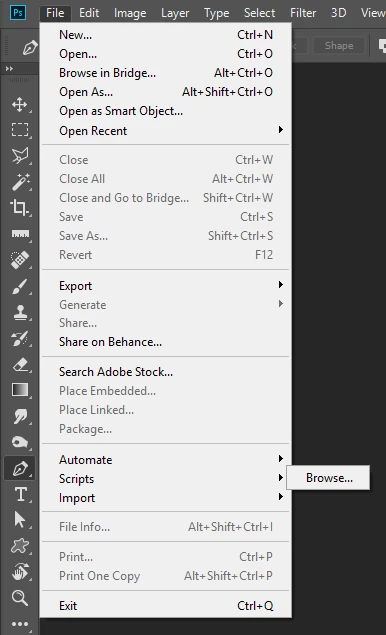

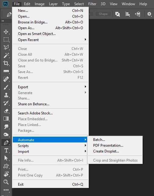

ScriptingSupport is one of Photoshop required plug it is located on Windows in Photoshop folder
"C:\Program Files\Adobe\Adobe Photoshop CC 2018\Required\Plug-ins\Extensions\"
Mac have a folder like this also..  When Photoshop start alls scripts are read and their manes added to the approbate menu script names item.  In Scripts, automate, filters wherever they are installed.  If your problem is cause by any of this processing you can try to eliminate that processing  by temporally moving the ScriptingSupport plug-in and the folder  scripts from Photoshop Persets to your desktop.  If your problem is related to Scripts Photoshop  should start without scriptingsupport and scripts. Do not forget to move these back into Photoshop
