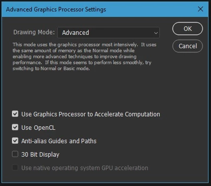

Today I formatted my PC, installed Windows 10, downloaded Photoshop from the Creative Cloud app, and I'm with the same issue. After looking for different threads of this topic, I'm almost sure that this is a problem of compatibility with the recent versions of Photoshop and the graphics processor.
This is the configuration of my PC:
- Windows 10 Pro 64-bit (Version 1803, OS build 17134.191)
- Intel Core i7-4790K 4.00GHz
- 16GB RAM
- NVIDIA GeForce 970/PCIe/SSE2 (Driver 398.82)
And this is the settings of the graphics processor in Photoshop
Aug 3, 2018 7:39 PM UTC
I have the same graphics settings and a very similar graphics card to Levaneng. Hmm...
