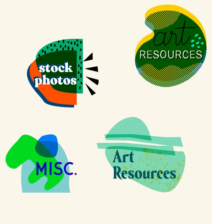

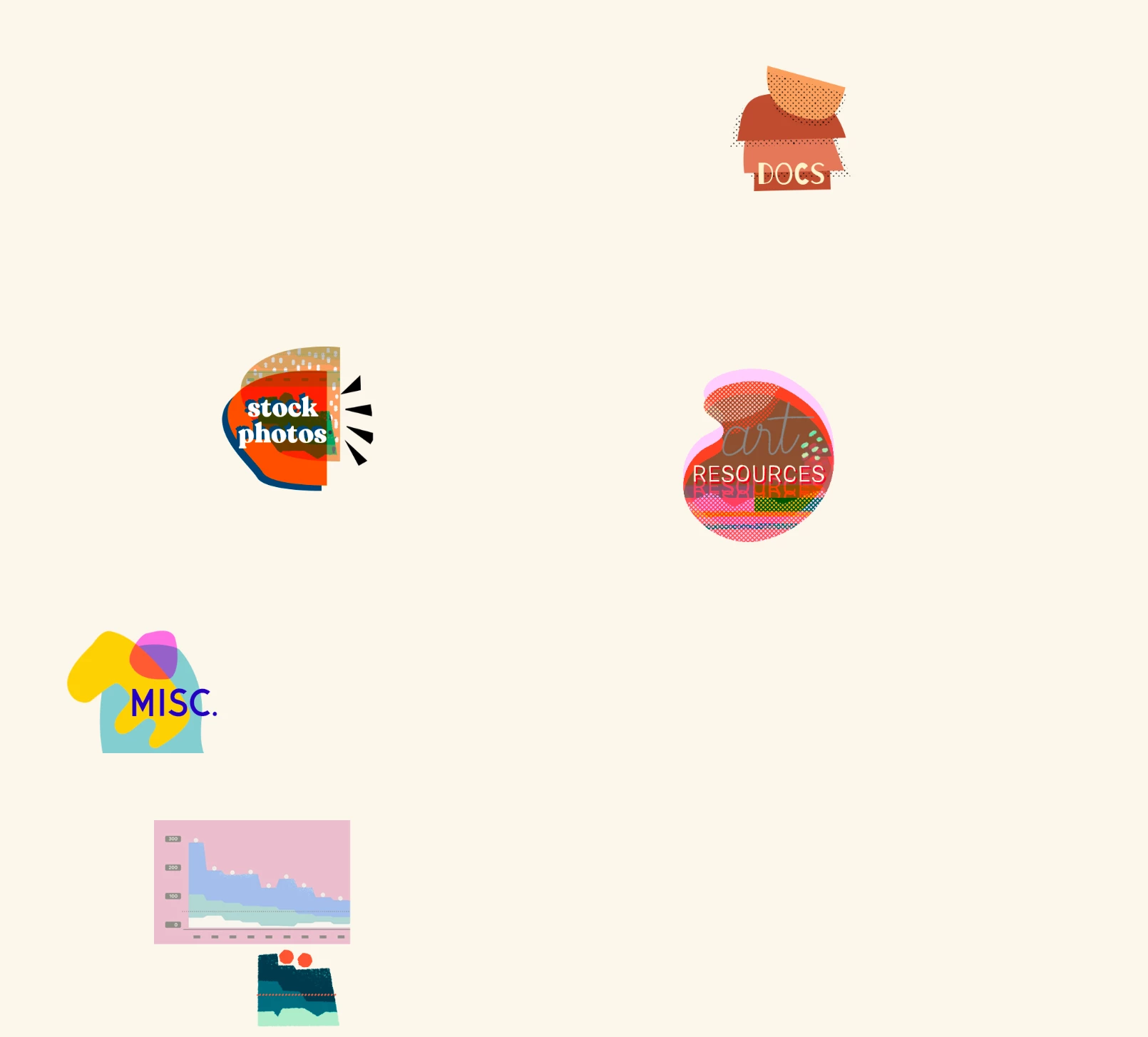

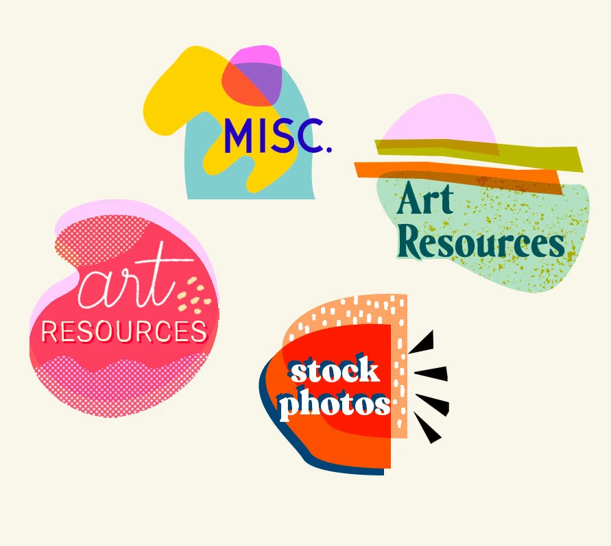

I'm making some custom folder icons (so I can see which folder is which at a glance and also Mac folders are boring and stupid), and as I was working, the colors of one icon completely changed - and not the one I was even working on. This happened after I tried to fill a clipping mask with color - it filled with a different color and the layer thumbnail had both the intended and different colors in it. I undid, then tried to fill again, and the icon I was not working on changed colors. In case this matters, the icons are all grouped together and have several different layers, which has never resulted in any issues.
At first I thought they somehow got inverted since I use a lot of keyboard shortcuts and sometimes hit the wrong button, but they weren't inverted - just completely different colors. I quit PS,  then looked at the space bar preview of the file - the colors were different from the originals AND different from how they looked in PS after they changed. I then checked for updates, updated from 23.3 to 23.3.1, and when I opened the file again all of the icons except two (???) were different colors. I checked the spacebar preview again and now it looks exactly like the corrupt PS file.
I read that the 23.3.1 update fixed color issues with adjustment layers, but I'm not using those - just regular layers; some are clipping masks but that's it. I also tried to do the fix for the adjustment layer issue to see if it would work, but I searched and can't find the file (MachinePrefs.psp) on my computer. Luckily the corrupt designs had already been copied to new docs and saved as PNGs, but I'm worried this will happen to something else I'm working on. I use PS every day for work and I can't afford to have my designs messed up since I'm always on a tight deadline.
I've attached photos of the original files, corrupt files, and the screenshot of the first spacebar preview after the colors first changed / before I updated.

Please set the Status Bar to »Document Profile« and post post screenshots taken at View > 100% with the pertinent Panels (Toolbar, Layers, Channels, Options Bar, …) visible.
