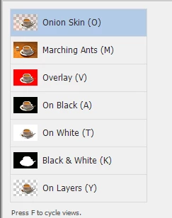

Try using the onion skin mode, in Select and Mask, instead of marching ants. It is much clearer as to what is selected and what is not.
With a select tool , selected on the toolbar, go to the options bar at the top and click on Select and Mask
The quick select tool is then the top tool at the left tool bar in select and mask
Before using it though go to the top right - click on view and select "Onion Skin" and turn transparency down to around 50%
If you now use the quick select tool - you will have a much clearer view of what is selected and what is not, than you get with marching ants
You can check the actual mask by going back to view and selecting black on white or one of the other options as below
You can then go on to use refine edge if required (2nd tool down)
When finished don't forget to choose what you want as an output (i.e. selection, new layer with mask etc - then click OK
Hope that helps
Dave

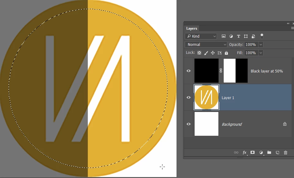

I don't think the visibility of the marching ants has changed since day one.  It alternates black and white at one pixel line width.
There's a trick that works with work paths, and that's to add a layer filled with black with it's opacity set to 50%, which is usually going to provide better contrast.  It seems to work with the marching ants, but it would also reduce image contrast making the selection a problem, so I doubt it would be useful.
You have the alternative ways of looking at the selection when in Select & Mask.  The Black & White option is going to be fully visible.  If you use your selection with a layer mask, then you can Alt click the layer mask to view it full size on the screen in black & white.
