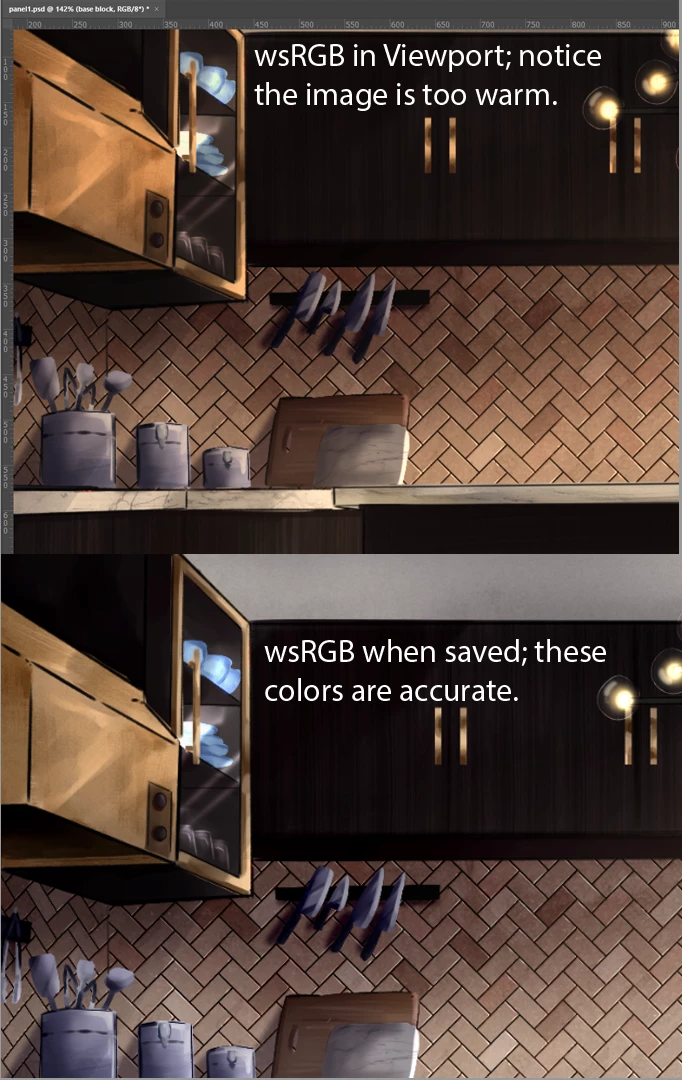

This issue is strangely complicated, so I apologize beforehand... However I'm at the end of my rope as to how to fix this problem.
In short: I do most of my digital painting in another program, and use Photoshop for editing and fine-tuning. I save as a .png with wsRGB.
Basically: Saving with the wsRGB profile results in the correct colors, but they do not display correctly in the viewport, obviously making it difficult to make edits accurately. My working monitor's colors (2752H) display the true colors, but saving with this profile results in a much cooler toned image. In order to see what I'm going to be exporting out, I have to use my monitor's RGB but save with wsRGB.
While I have a workaround, I'd really much rather just be able to work in the profile I'm saving with, and be able to see what it's really supposed to look like. I recently upgraded my computer and have a new GPU, and to my knowledge this problem didn't start happening until then.
Images below (sorry they're kind of messy):

ERAeternal
January 18, 2020
Then why haven't I had this problem before? My colors used to look identical between all programs and I could save back and forth if I wanted to without any problems. This is a new issue which means something must be off. I did a new, clean install of Photoshop and deleted my old settings and the same is still happening.
If it's my monitor's color settings or a graphics driver or... something else, I'd just like to know why Photoshop is now giving me different results when before it did not.

It looks like you are misunderstanding colour management. You don't change and experiment with colour profiles, you use the right one. So the document profile tells the colour managed application which colours are represented by the RGB (or CMYK) numbers at each pixel. wsRGB is irrelevant and was an experiment in wide gamut. The monitor profile should never be assigned to the document as that just disables colour management.  For the document - stick to Adobe RGB, sRGB or in certain images ProPhoto. If you download an image without a profile, from the web for example then assigning sRGB is often a safe start point.
Just as important is a monitor profile, set in the system that describes , your monitor with its current settings, and a printer profile that describes your printer, ink and paper combination
If comparing to other applications , be aware that a properly set up Photoshop, or colour managed application displays colors correctly. Applications that do not use colour management (there are many viewers and painting applications that do not) do not display colours correctly. So a big question is , is your painting application color managed (i.e. does it use a document profile and the monitor profile when displaying colours on screen) and is it embedding the document profile in the saved document.  If it is then in Photoshop just setting colour management policies to "Preserve Embedded Profiles" will ensure correct display as long as your monitor profile is set correctly in the operating system.

January 18, 2020
What is the “other program”?
Is it colour managed?
what do you mean by a “viewport”?
