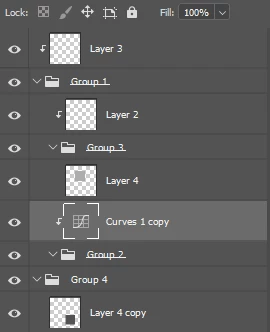

Photoshop crashes ONLY when I add a Solid Color or Pattern adjustment layer in a situation that is hard to describe in words and easier to show in a screenshot:
This happens in 100% of attempts only if the situation is as in the screenshot. If you change anything, the crash doesn't happen. (such as removing one of the Clipping Mask layers, or removing one of the folders that are below or above, or if you select the wrong layer that is currently selected in the screenshot)

As I described above, it requires a very specific set of folders and layers to recreate this situation. I first discovered this in one of my larger projects. However, by eliminating all the other causes of Photoshop crashing, I came up with the most minimal set that is guaranteed to crash my Photoshop.
I recorded a video where I show that I can create Solid Color while other layers are selected, but Photoshop crashes when I select a particular one:
I'm also attaching a PSD file with this set of layers. However, I asked my friend to open the file and repeat the steps on his PC and it didn't seem to cause him any crashes.
